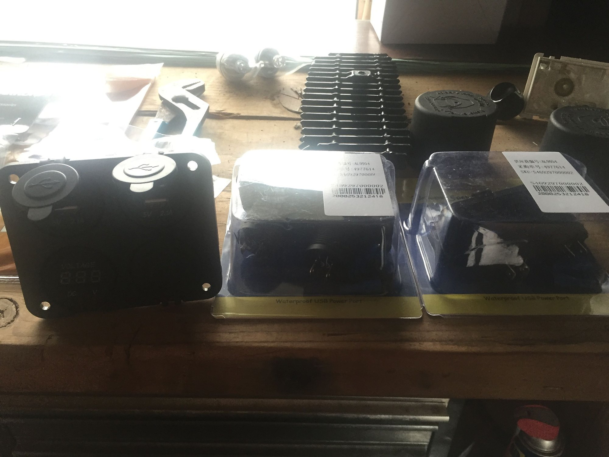

My seats are still in while I am mounting this. I just figured out that I am using the wide base model.It has the cools Retractable cup holders in the rear. It fits in tight with the armrest down. I got it out of a pick and pull. I also just realized that I didn't grab the brackets to mount it to the floor.
I did pick up this
Invertor Invertor
to install the USBs and 110 volt outlets. Can you shed some light on how you built the new panel for the USBs and 110 Volt outlets? I was planning on using Aluminium. Looks like its back to the drawing board

I used a piece of 1/8" MDF to make my panel. But alunium, plastic or whatever you have the tools to make it from will work fine.
I cut it to size and painted it to match. It attaches to the console with the same screws as the factory control panel. For paint I used a satin enamel that matched.
