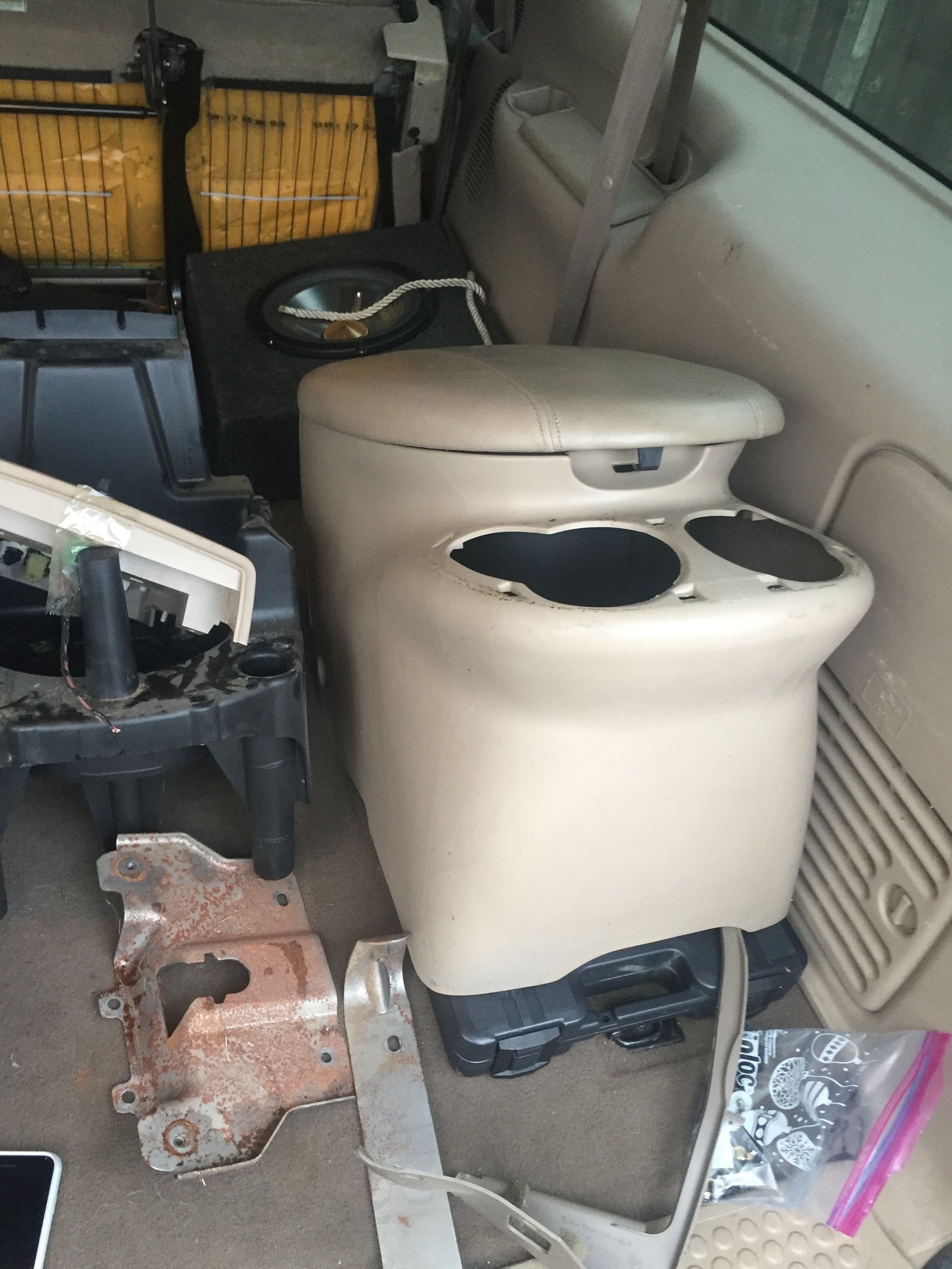

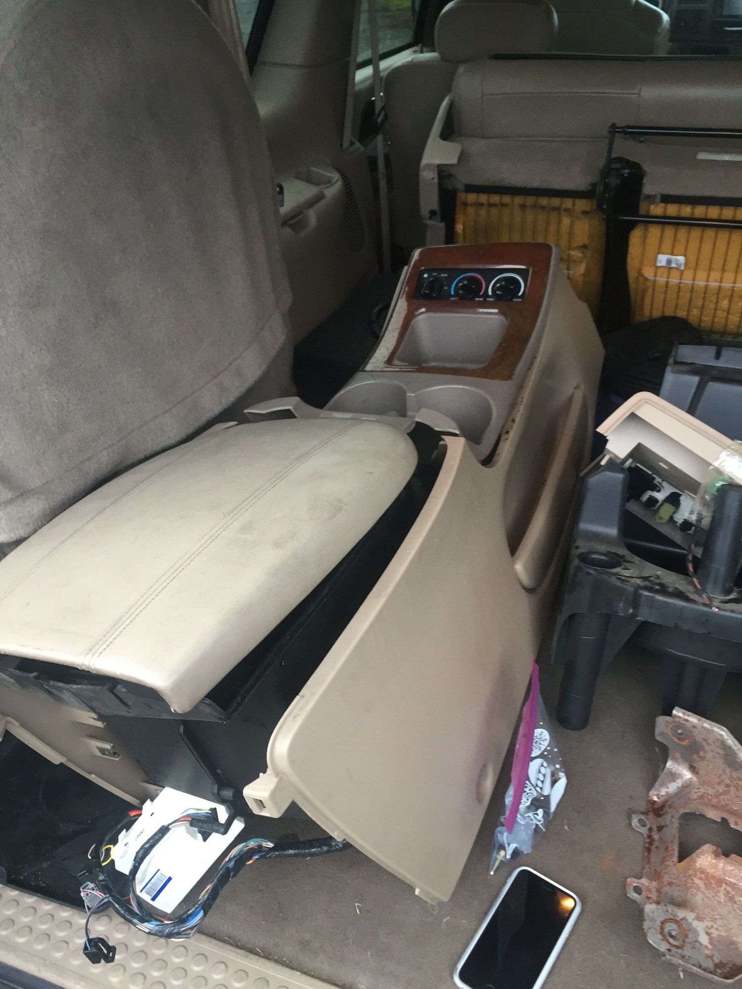

Just picked up the center consoles, I hope I can remember how they went together
I was able to get both the front and back console, mounting brackets and all for $100.
There was one missing piece from the front console, but I am sure I can find it on the interwebs if I really want it.
The colors match mine PERFECT!
Both
Front
Back

Does the rear part of your front console have pull out cup holders ?
I dig the rear console, that would be my choice if I didn't have the ARB

There is a plastic molded cup holder that I needed to take it out to get to the fasteners.
Now I just hope I can get all the mounting plates to work on the Ex. It should be an interesting puzzle.
On a side note, I really like how yours has the cup holder in the back.
The one I scored does not have this, instead there are climate control switches and an audio plate for the built in entertainment system... I am going to have to get creative with these spaces

The location of those climate control switches in the front would be perfect for some rocker switches for additional driving lights or what not. Just make a new mounting panel.

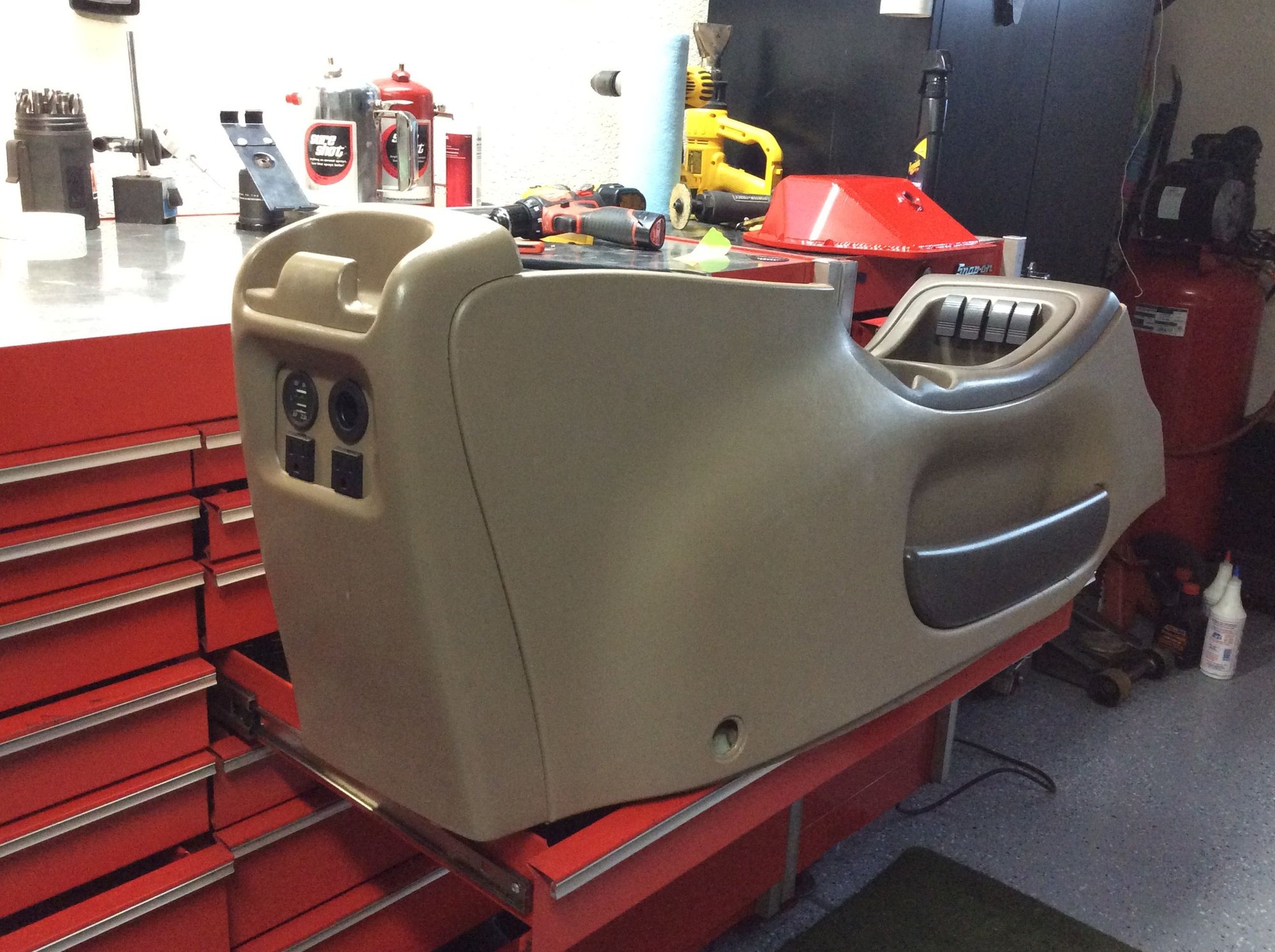

Time to start the fun part
