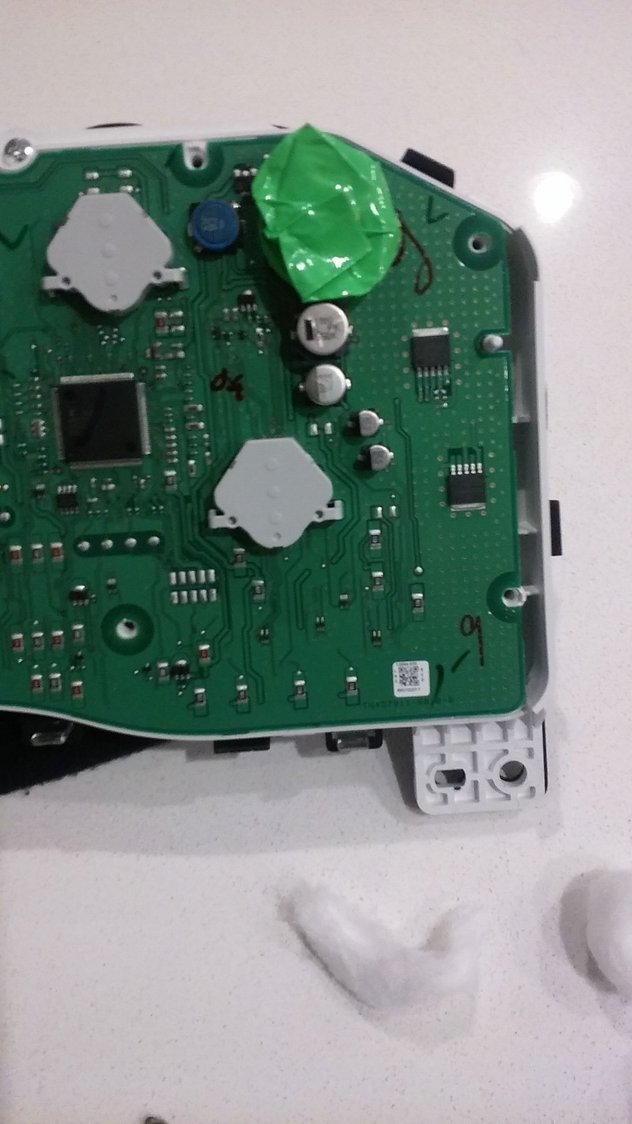

The door latch thing works but it is something you would have to do everytime you open the door. I too use the truck radio on the job, I ended up putting tape over the chime speaker. Everything is now silent including the blinkers.....

where is that speaker? that is the logical fix for obnoxious ford door chimes but I've not been able to locate where sound comes from.
thanks in advance
thanks in advance
Located on the back side of the instrument cluster (green tape). I also put a little piece of cotton ball in the speaker before I taped it. You can't hear anything. The only odd part is the silent blinker. After a week I am getting used to that though.
