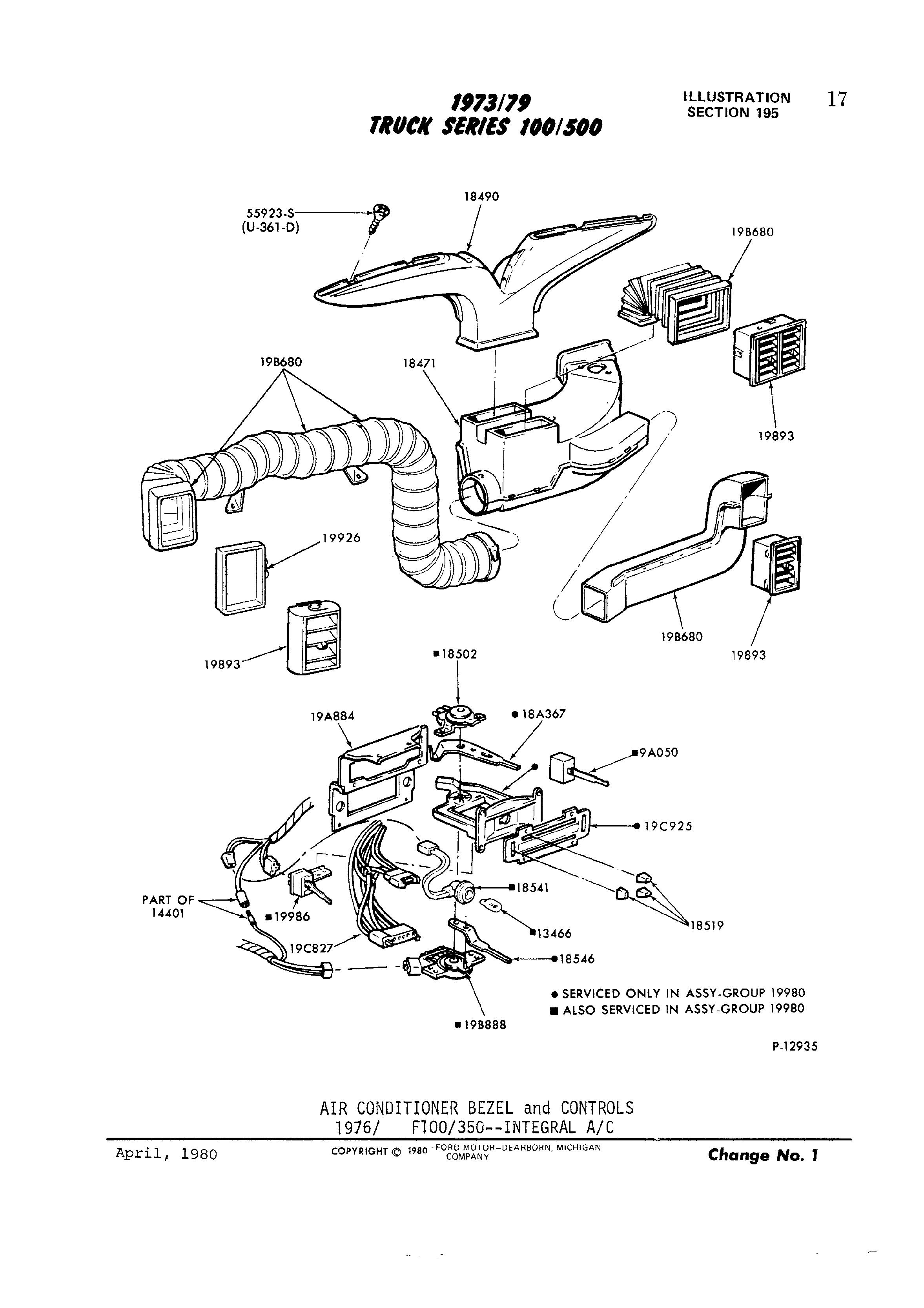

Originally Posted by NorthEastTexasHog
'77 F100 Ranger with factory A/C. The blower was previously working. I had some work done and now it is not.
I can hear the vent opening and closing as I move the controls on the dash.
You can hear a CLICK, as the compressor is turning on. Each A/C 'blend door' is controlled by a separate vacuum motor (lower pic).
Compressor "kicker switch" is part of the 19B888 = A/C Vacuum Control Solenoid Assy., bolts to the back of the A/C heater control panel. All the vacuum lines connect to it.
A/C heater blower switch is 19986 (upper pic). Blower motor resistor with factory A/C is 19706 (lower pic).
NOTE: Factory installed integral A/C is combined with the heater.
