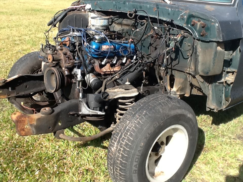

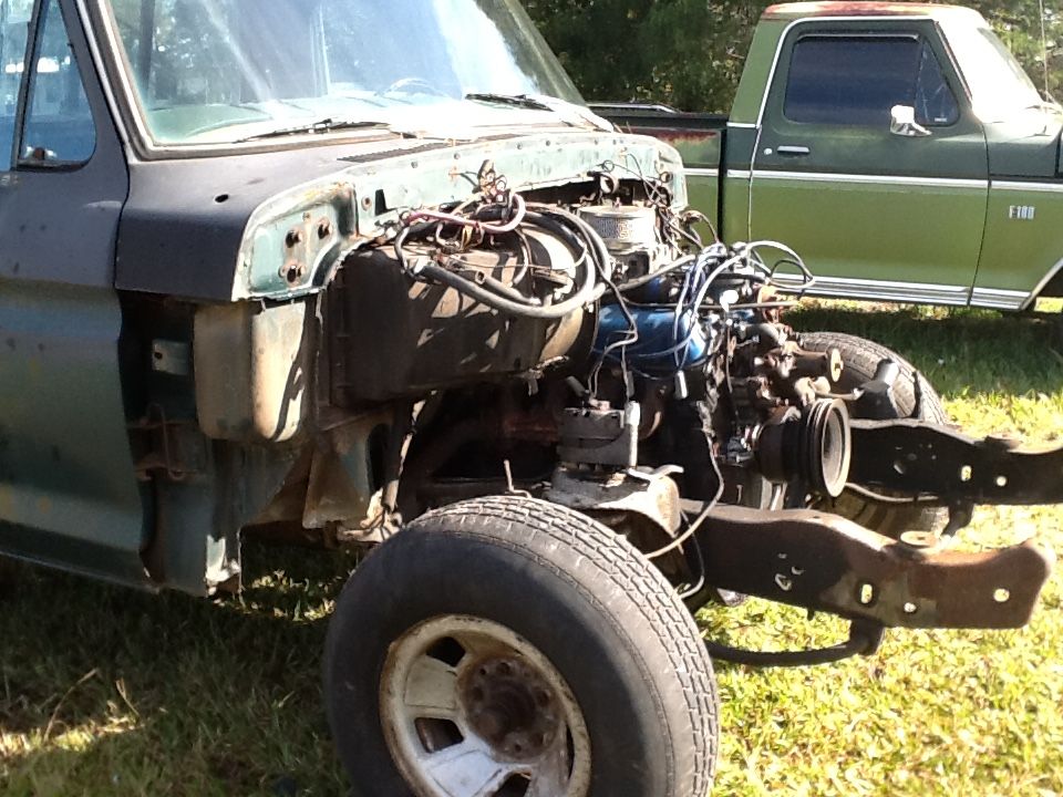

So pulled the front clip and removed the intake and heads to see if the block would be salvageable...

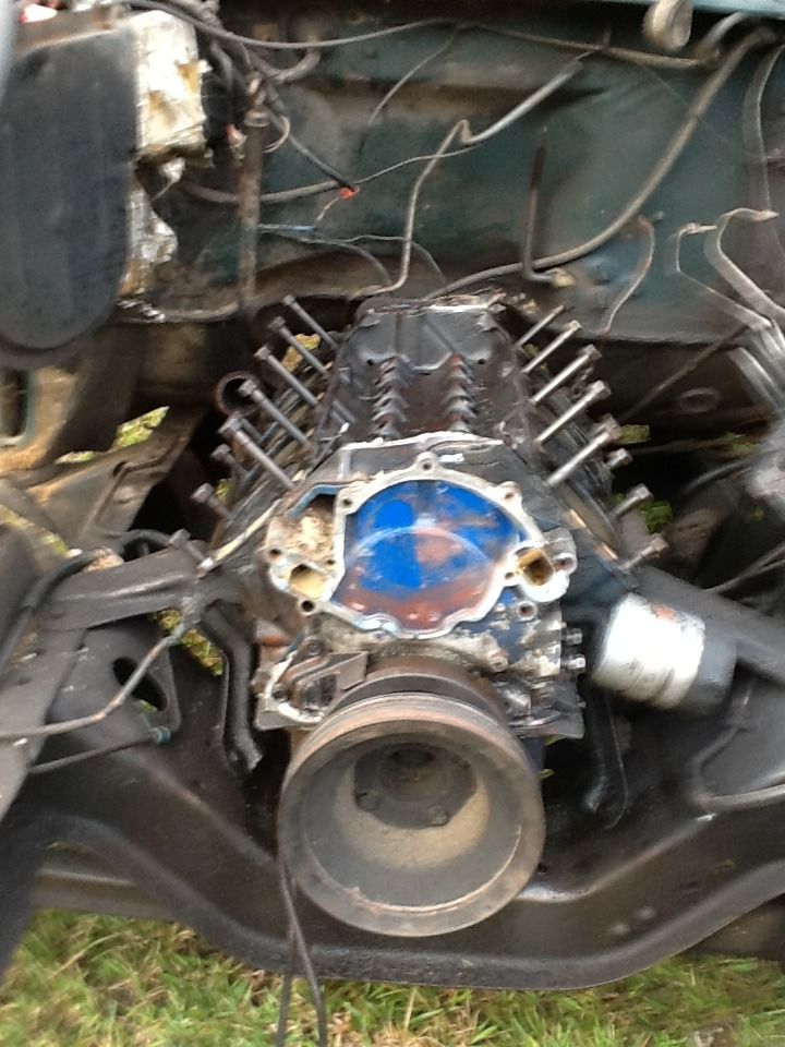

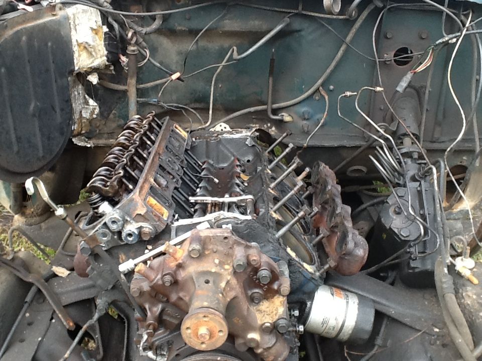

Some wonky looking brackets for the alt and PS...
Front clip is as close to perfect as I have seen on an unrestored truck..
Managed to pull the front clip without unhooking most of the wiring so far..
Take it from me, remove the exhaust manifolds from the pipe while they are still bolted to the head...
So here it is, stripped down to short block, mostly. The cylinder walls look good, so I'm hoping to ball hone the block instead of having it bored...
