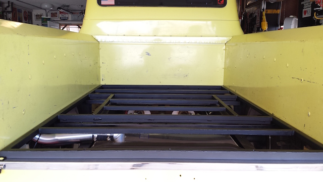

Originally Posted by smallello
The frame sits on top of the original bed flange which makes the new bed sit about an inch higher than the original wood.
Attachment 131973
Was there a reason why you raised it the one inch? Or was it just for the support of the floor

Originally Posted by Moe Craig
Was there a reason why you raised it the one inch? Or was it just for the support of the floor?
I put the frame on top for a couple of reasons.
After I flipped the rear leafs the rear end center section was close to the bottom of the bed. So adding an inch of clearance helped.
It was also easier to install. I didn't have to hold it up underneath, just had to lay it on top and bolt it down.

Originally Posted by Greg Rogers
Great job on your bed floor and the extender- Good thinking!! I saw your replies to another thread about fuel tank location, I like your tank and filler also!! I don't want to have the filler in the bed as most do. Does it fill ok? It looks like you may have to fill it slowly with that tight 90 elbow, but is it ok or very hard to fill? Thanks Greg.
Thanks! When I first installed it I had a little trouble filling it. I had a hard 90 at the the top of the fill tube also. I changed it to a metal fill tube with a 60 degree bend at the top and added a 3/8" vent tube from the top of the tank up to the top of the fill tube.
