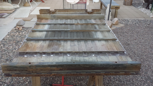

This is what I started with. Not too bad but had some pitting and rusted edges. The really bad rust was in areas that I knew I was going to cut off so it was ok.
The first thing I did was cut off the corners that I didn’t need.
I cut it to size for the width. It was only about 1/8” from each side after the corners were removed.
I also removed all of the braces I didn’t need. Then welded up any holes and hammered out the dents. It didn't have to be perfect since I planned on using bed liner.

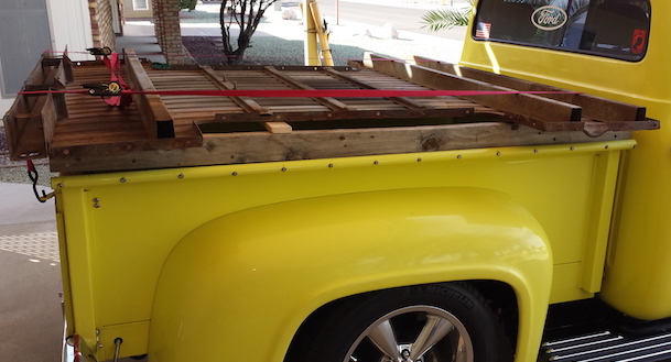

Shoulda just left the 56 alone and bought the Chevy to haul stuff around...that's what I did, and look there's a nice 56 cab in the back!
Old Dec 29, 2015 | 10:26 AM
56panelford's Avatar
56panelford
Posts: 283,939
Likes: 8,377
From: northwestern Ontario
That's how I brought mine home too...

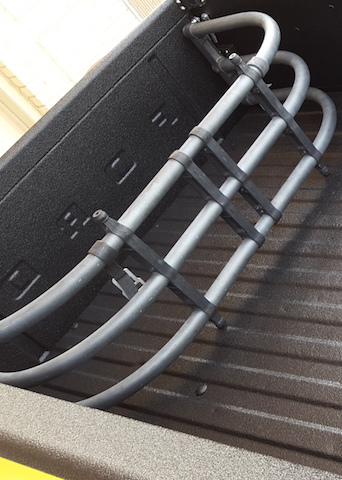

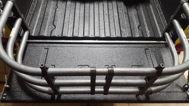

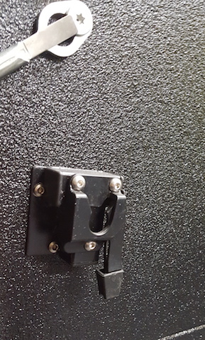

The box looking items are mounts for the bed extender. I had to move the mounts out to clear the tailgate cables and latches (seat belt buckles). It also helped with a way to mount it all. I welded 1" tubing to a 1/8" plate and bolted the mount to it.

You added a real cool and handy feature never seen in them old trucks. That was an option that came with the explorer's wasn't it?
You deserve reps my friend.
Old Dec 30, 2015 | 04:06 PM
smallello's Avatar
smallello
Are we there yet?
Joined: Mar 2006
Posts: 1,098
Likes: 64
From: NW Valley AZ
Thanks. I don't think I have seen a bed extender in these trucks.
The guy I got it from said it was from a Ranger or an F150, he wasn't sure. It was definitely too wide when I got it.
I had to take it apart and cut down the tubes about 3 inches per side to get it to fit.
