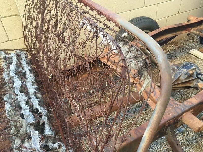

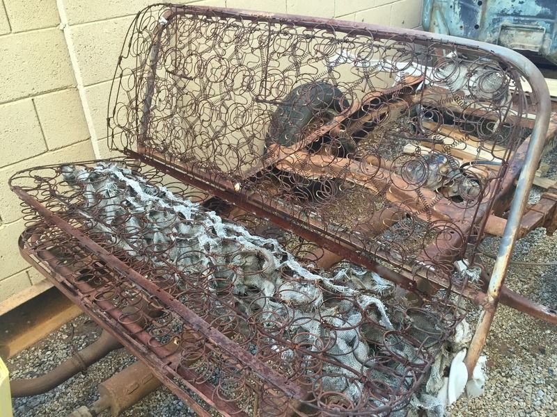

Rusted bench seat

Good stuff! Thanks for sharing! Please post the in progress pics if you can find them. I think we will head over this weekend and try to pick up the frame and a few other parts.

YES,YES, you must share the pics. Your seat is just what we need. I am trying to use a bench seat from a '70. Springs are shot and I have to take a couple inches out of it 'cause it's too long. To compound matters the only upholsterer I can afford doesn't speak English. Where did you access the high density foam?

Went over and picked up the seat this morning.....
Hopefully, it will turn out. Went to a car show this afternoon and saw a few trucks with "newer" bucket seats, etc and it just doesn't look right.
