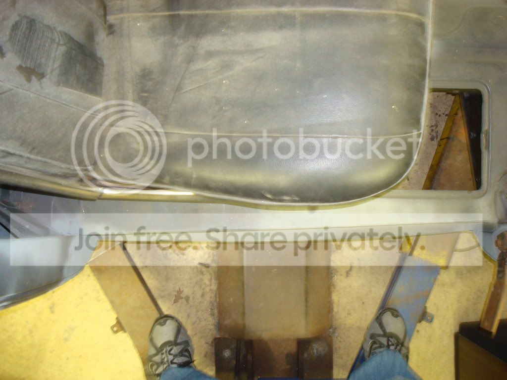

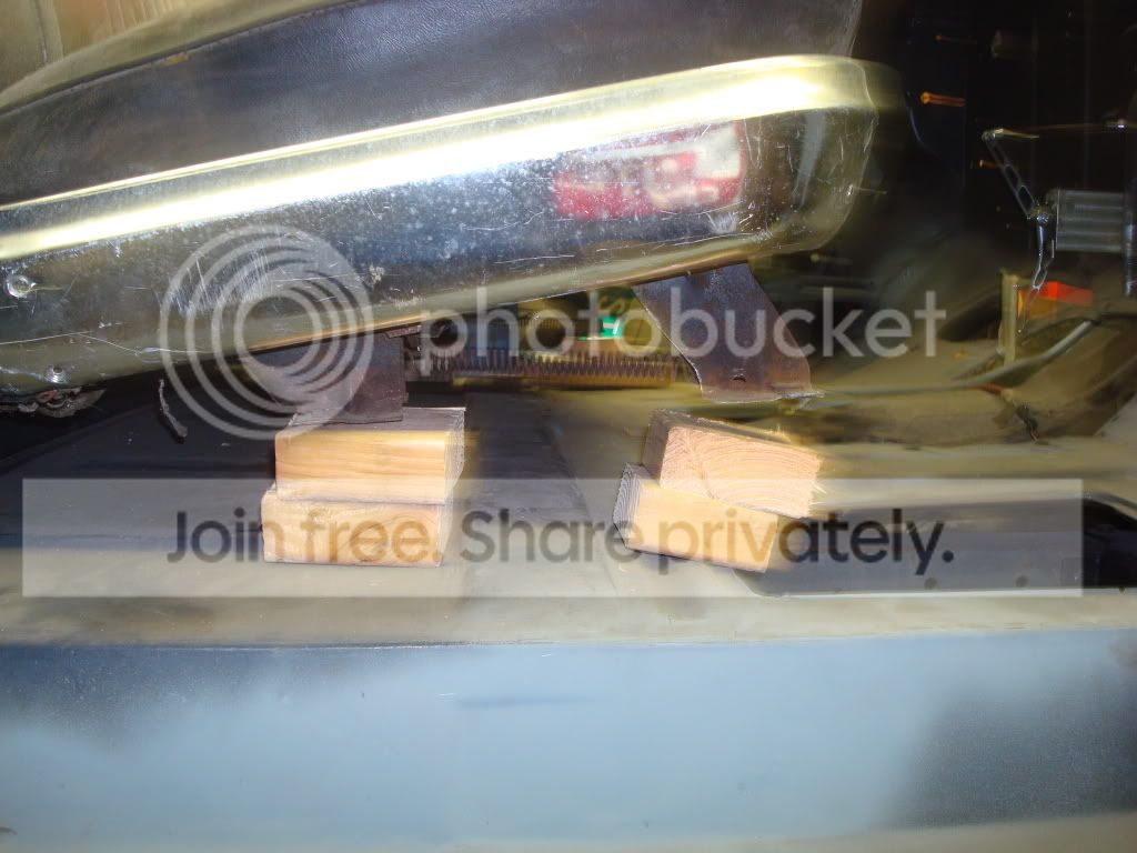

I have a unknown bench seat that i want to use in my 55f1. This is my plan of attack. I put the seat in the truck and raise it up to the height that feels good as if i where driving. Heres where i have questions. The seat tracks slide front to back say. I thought that i should mount the seat with the tracks all the way forward so the seat would be back as far as it could than mount it. This is so the seat could come forward for what ever reason need be. With this being said the front of the tracks are at the front edge of the seat. When you look from the side theres really no support on the back of the seat. The runners are not very long. Should i move them back to better center the seat? I was sitting in the truck making vrooom vrooom sounds and cruising in my mind and the seat felt good all the way back, mind you im only 5'5" tall. To me it seems like the only reason the seat would move if someone shorter than me drove the truck. I also have a set of bucket seats that i could use as well but than that means only to can go in the truck? Do you guys have any ideas or is there the perfect seat out there to swap in? Thanks Roger

I put a bench in mine for that third person, just in case.
You will want to fashion some kind of support for the rear of the track. It really needs to be solid in case of that unexpected nudge from someone not paying attention.
I made the seat move as well. I am 6'2" and my wife is 5'2" , tho she says she will ne'er drive the Mistress anywhere.

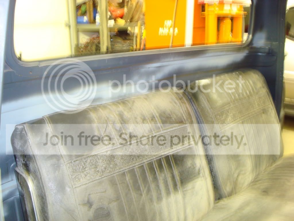

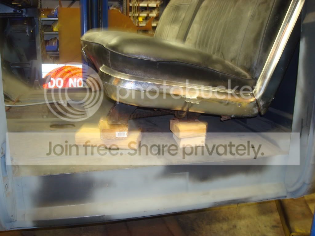

Do you think the seat is good with clearance by the door?

The back will sit alittle higher than this.
Not sure why all the pics are getting blurry.
back sure looks low!.. mine is just above the bottom window gasket on my 55.
i think you won't have left right issues, long as u don't need to reach down to adjust the seat.

Its got to go higher and tilt forward abit. I like how Ben made his mount. I wonder how that box was made?
Ben, do you have any build pics of the seat box?
