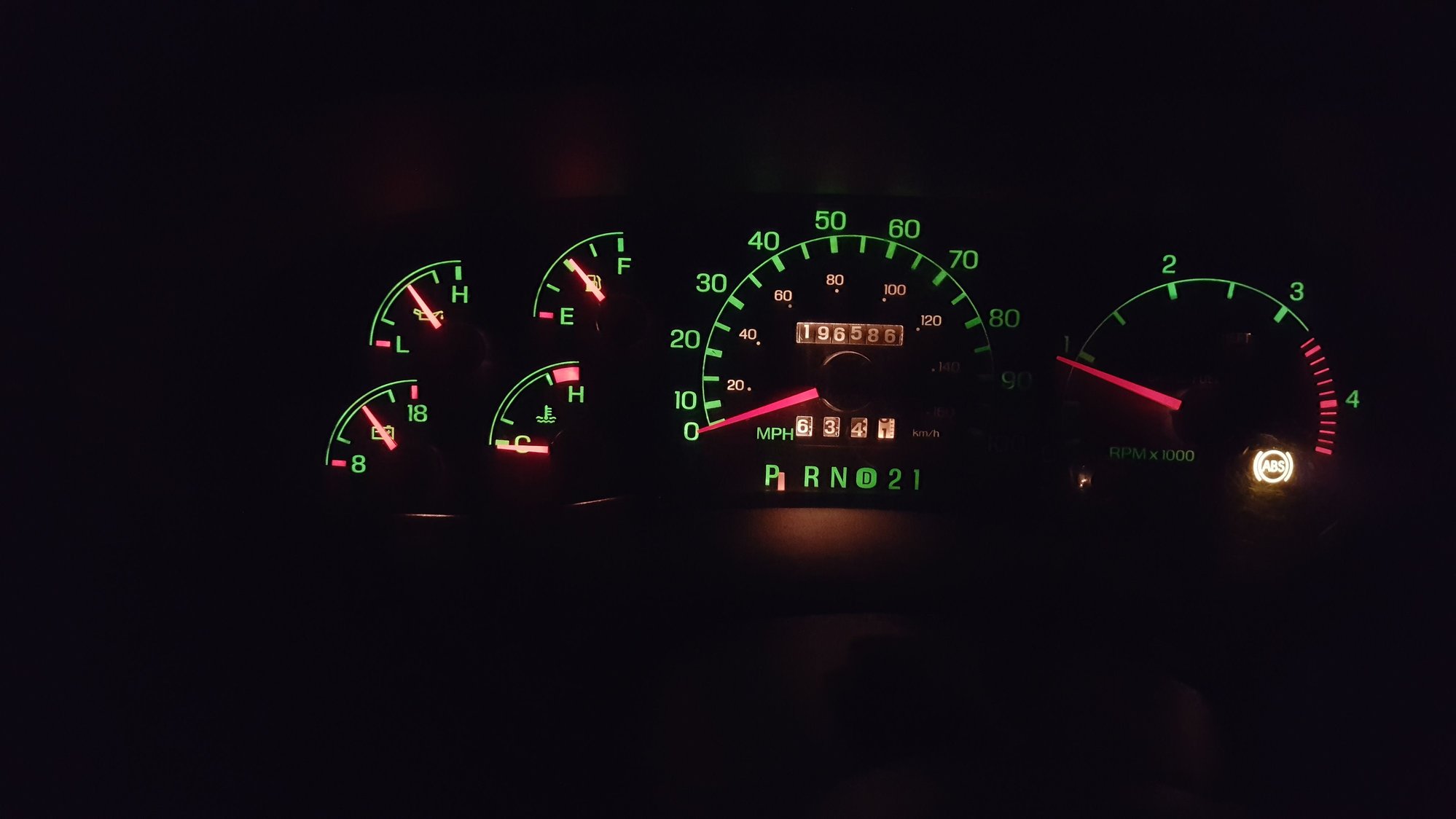

17° almost didn't start
I have conventional oil. Block heater plugged in all night. I don't have a timer for it yet. Batteries had plenty of juice. Lot of white smoke. It's Iowa, so it's only going to get colder eventually. I have to park it outside. What things can I do? High idle did kick in after I took this picture but it took about two minutes after starting.

As far as I know it's all original. I've only owned the truck since July. I was wondering about that heater. I will test it tonight and see what if it's even working. I might try an oil change next and run synthetic in it.

He didn't say how many miles though.
