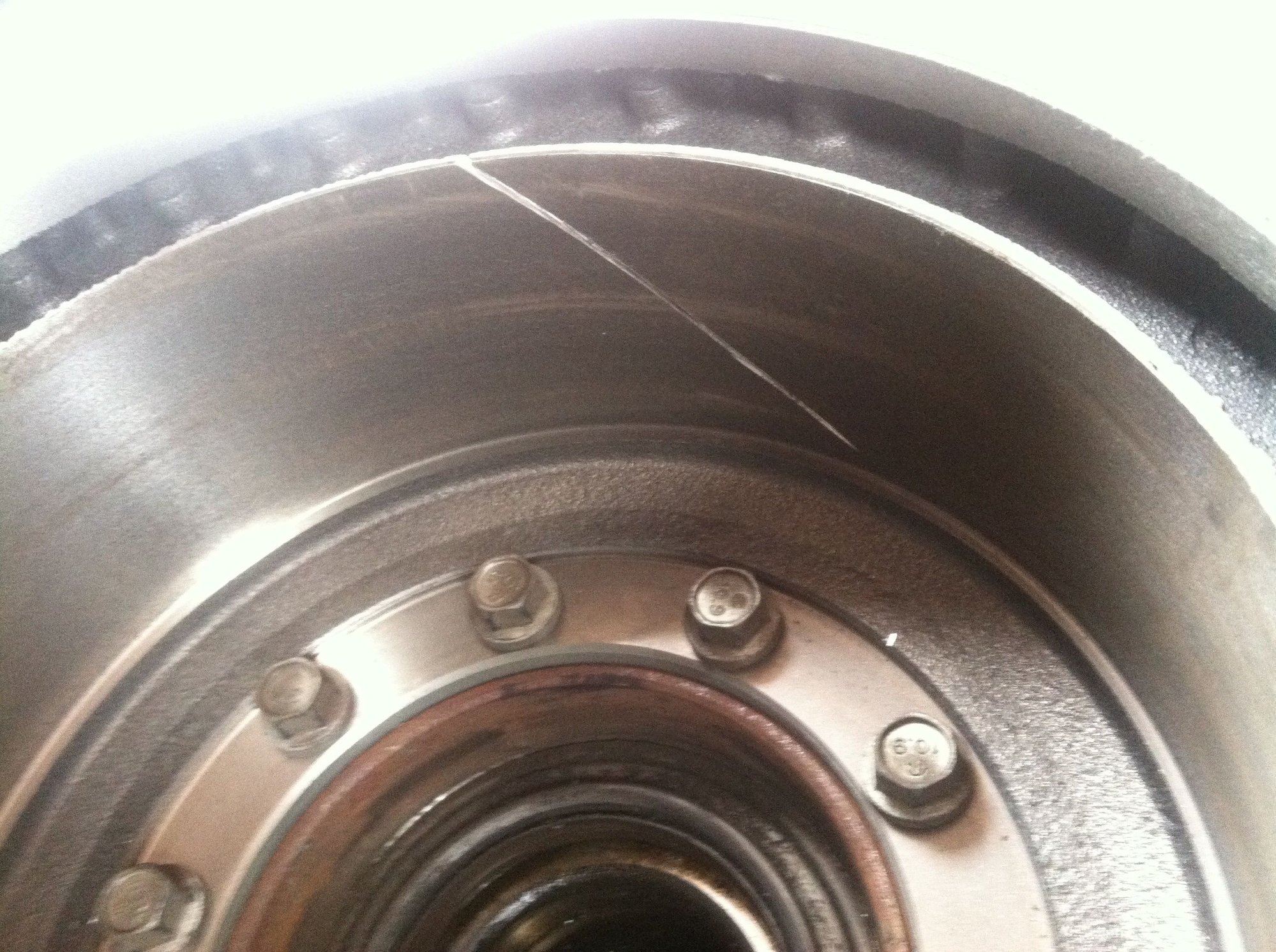

Oh yeah, I added some slots to the e-brake drums too. After being properly adjusted, it will now actually hold this 5 ton truck on a hill and you will not drive away and forget it is on!!
While this is an important safety feature in this 6spd truck, it's a really good idea to use a functioning e-brake with your 4R100 as well. The park cogs don't really take much abuse and a loaded truck/trailer on a hill can cause them to fail.

I have tremendous respect for your mechanical abilities, Jason, and I certainly don't want to throw stones at your work, but I do have a question about your drum face slotting technique.
I assume that those slots are rounded bottom slots? A sharp angled bottom geometry in the slot would create potential crack locations otherwise. As it is, the hoop strength of the drum is slightly compromised with any slot at all, especially with it being slotted all the way through the outer edge like that. At the same time, though, your having angled the slot in a "spiral" orientation does help mitigate the hoop strength reduction issue.

I cut the slots with a cut-off wheel. I suppose there is a chance of failure with this hack job, but this drum is probably 10lbs. There is a LOT of material here and I'm banking on it being ok.
I really want to find a real solution to the parking brake problem on these trucks. Seems like a knurled finish in the drum would be good and not create stress fractures like this could. A stand-alone driveline brake would be pretty sweet.
After suffering for 300k miles in my own ZF6 dually, I'm just desperate to find a better way!! This works REALLY well for now at least! If it fails, I hope it is not catastrophic and I doubt the autoparts will notice my little mod when I return them under the lifetime warranty.

Having done the rear brakes myself several times, I know there is a lot of meat on those drums. I guess I was thinking more along the lines that someone like me could easily get away with the score lines in the drum face because I'm not really stressing my brakes very much at all. With your self-acknowledged level of heavy towing in and around mountainous terrain, I was trying to take into account how all the extra heat and stress from your driving conditions might be a game changer in your situation as compared to mine. Hopefully, it's just my overly conservative engineering mindset kicking in and stirring a little dust where it might not make any difference.

Well, now I'm in the dust and giving the DIY slots more thought... That can make my head hurt! I dismiss heat from the e-brake friction, since that should not happen - but, the rotor surface can see 500* or maybe more during extreme braking. The drum/hat area will see at least a portion of that heat.
I should clearly disclose that I don't recommend others do this, just from good engineering practices.

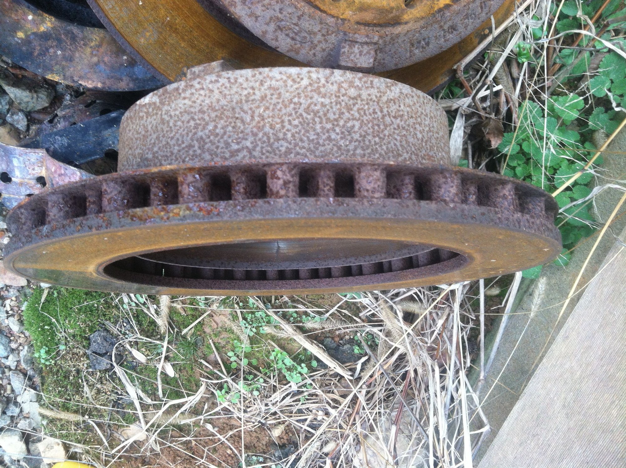

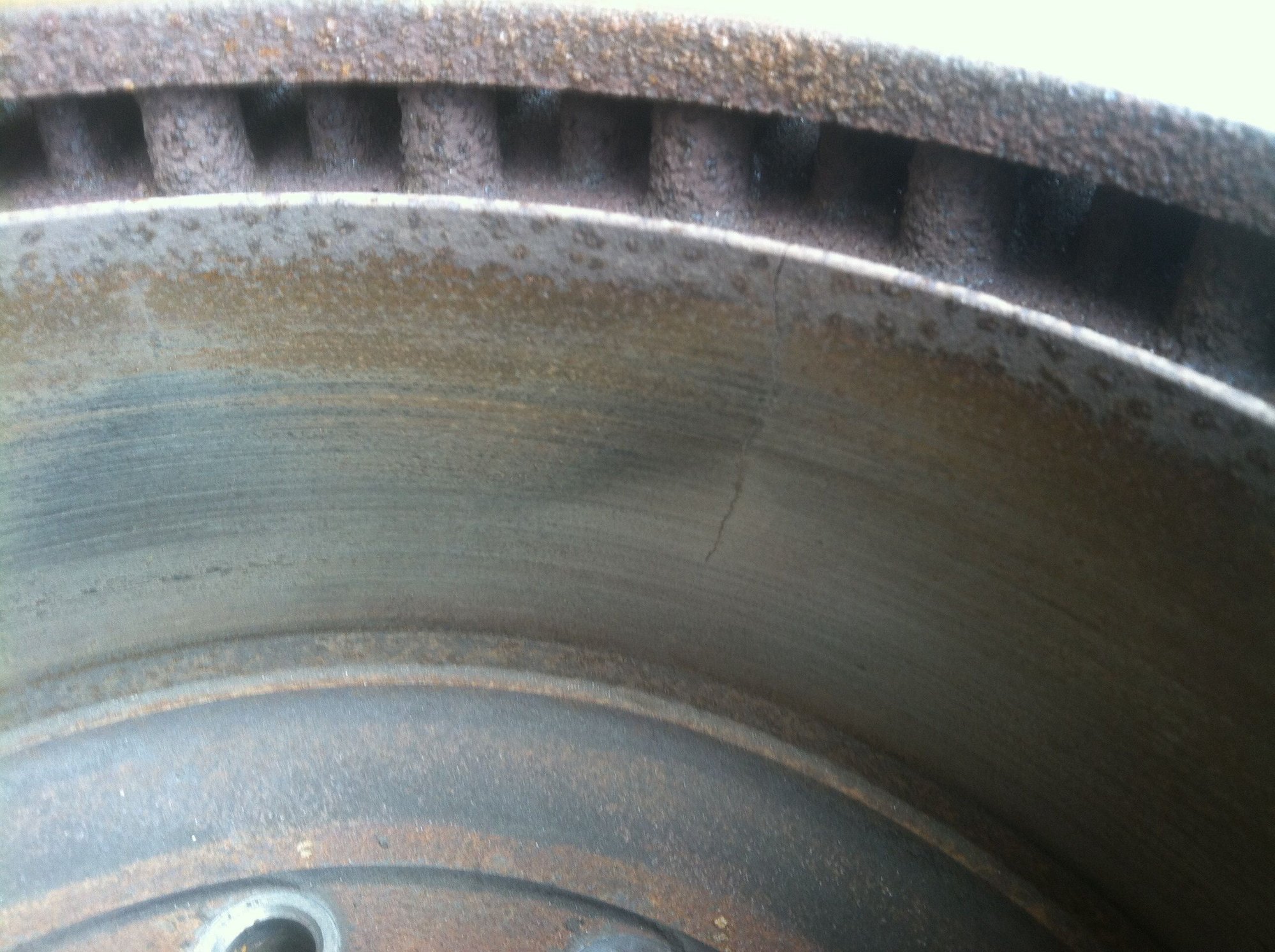

I went out and studied the old rotors. Both were beaten well beyond any reasonable expectation of severe abuse. You'll see in 2nd pic what I mean. I was surprised to see cracks in the drum! Not life threatening, but present.
