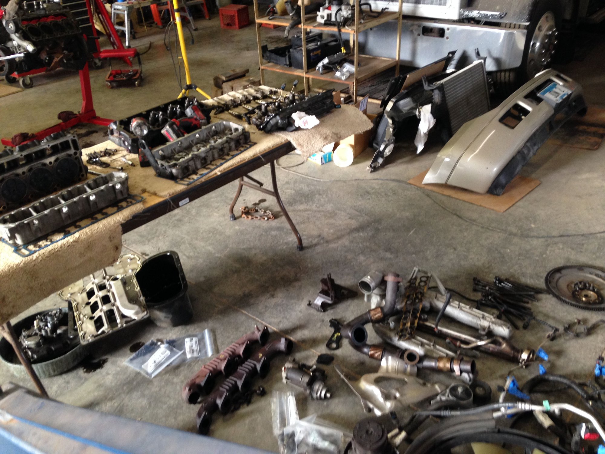

The first thing you need to ask yourself is "how long do I plan on keeping the Trk"?
I agree completely with Anthony,
I had an injector tip break off on my wife's 05 in sig, I had to pull the engine, once I got in there it got done, all of it!
Front and rear cover seals, front and rear main seals, bed plate gaskets, studs, heads completely gone through, all new injectors, all new glow plugs, new oil cooler, lifters, BP EGR cooler, etc, etc, .....
Fwiw you can get a set of lifters from Ford for around 200 dollars. I wouldn't be happy with myself if I had to pull an engine for 200 dollars with of parts that I should have done the first time. If you are going to keep it pull the engine by all means and do it! JMO
