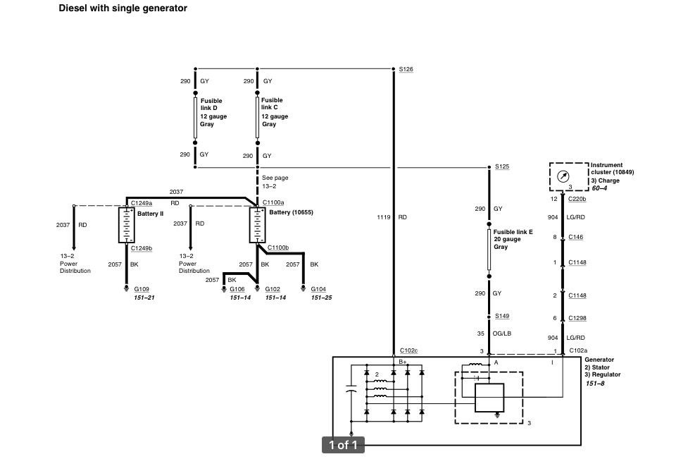

wire schematic alternator
2006 F350, need to find a good place to tie into the alternator field wire for the remote start.

Old Nov 28, 2015 | 01:45 PM
Rusty Axlerod's Avatar
Rusty Axlerod
Joined: Feb 2011
Posts: 8,241
Likes: 155
From: L.A. (Lower Alabama)
Alternator circuit
