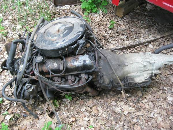

Hmmm I wonder if maybe it is a 460 and just mislabeled. The pictures on the ad are hard to tell if its a 360FE
Post the link to the ad... we've got eagle eyes. In fact, we can spot a tattoo on a mosquito's butt. Yes, we're that good.

Old Nov 11, 2015 | 11:42 AM
sam.tucker11's Avatar
sam.tucker11
Posts: 8
FE engines spark plugs are angled in in the middle correct?

thats a 302/351W

Ohhhh well imagine that. Thank you all very much for you help!
