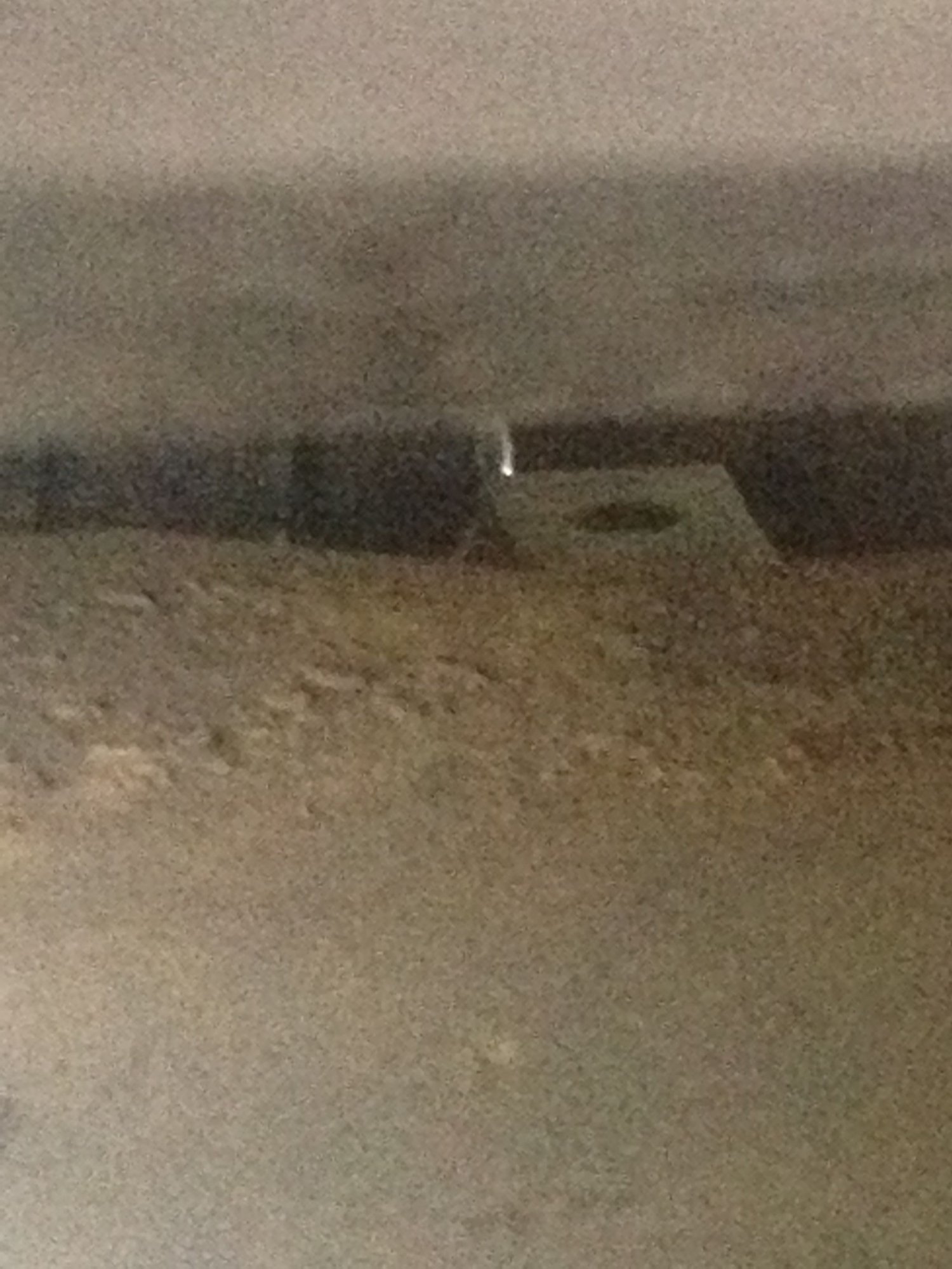

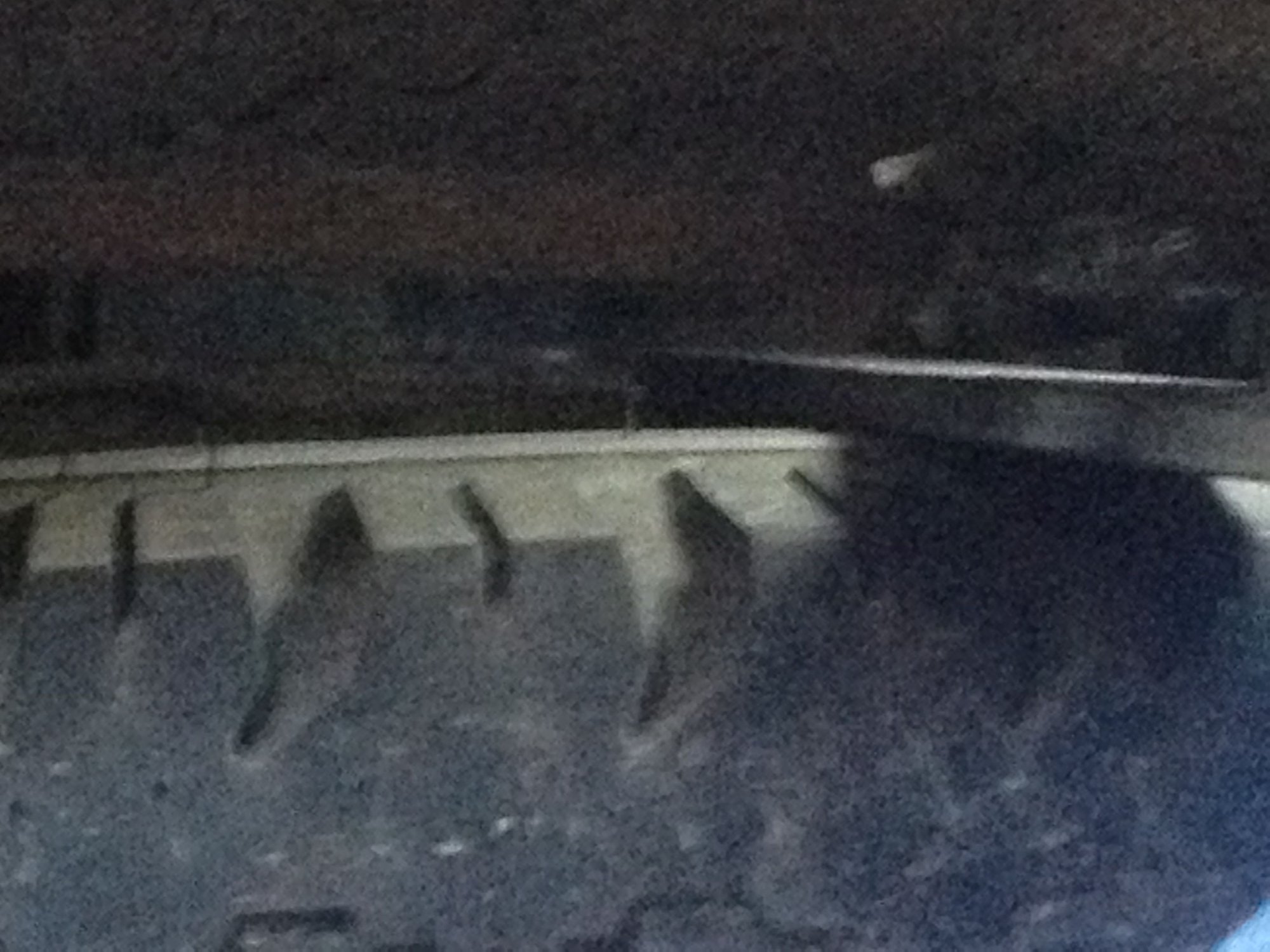

Learned here on FTE to just remove the lock, because if thieves wanted to get to the tire, they would just cut the cable holding the tire up and then you'd still have the lock on there and no winch cable, so, this is what I did:
Took a flat piece of steel and just hammered the lock off from the driver's side wheel well.
First picture is steel stock up against the side of lock.
Hammered the lock off at less than 90* angle.

After I posted this I did a search and based on what I read I was able to get the lock off as follows:
I had some wood wedges that I drove in between the frame and spare tire on the driver's side. That gave me just enough room to get my hand inside, I could see the lock. I used a long flathead screwdriver to pry the lock out some then grabbed it with some needle nose vice grips and rocked it back and forth until it came out. After that I was able lower the tire with the long rod and tire iron.
So now my spare is not locked, oh well. Has anyone ever had their spare stolen? You've got to be hard up to steal a spare
