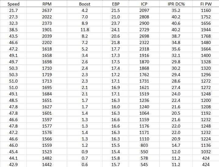

I'd say if it is not fluctuating evenly with the boost then the EBPV may be restricting it from coming down. Below is a sample from the Torquepro app that shows the EBP pretty close to barometric pressure (14.7ish) plus boost. I do not have an EBPV, and just fixed my leaky EBPS tube this summer with a new sensor.

Bottom line is that anything restricting exhaust flow through the turbine of the turbo is going to cause a decrease in fuel mileage. This is the same for leaky up-pipes or a leak in the turbo outlet into the plenums.
If your EBPV is malfunctioning and obstructing the exhaust side of the turbo then your EBP will remain a constant high while boost is reduced. You need to look at what your back pressure is at idle. It should match barometric pressure within a couple of tenths.
The torque log above doesn't account for atmospheric pressure of roughly 14.5 psi, so the highest reading is actually 24.1 minus 14.5 for back pressure of 9.6 with boost at 11.8 psi.
