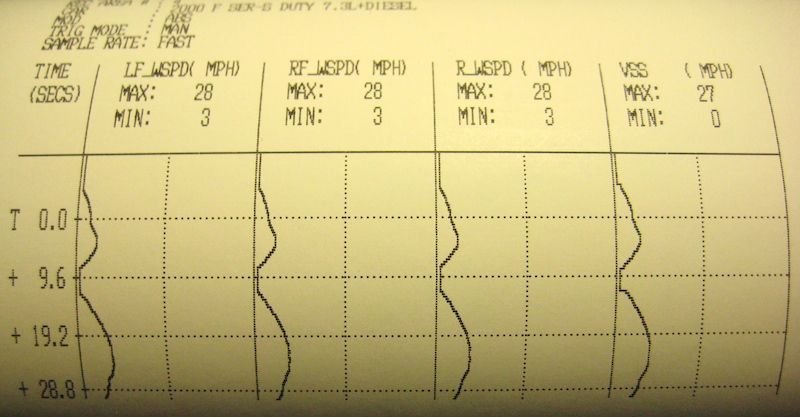

Here are a few pics of how the scan tool collects data from the wheel speed sensors:
Basically, the ABS computer in the truck is comparing the wheel speed reported by each sensor, with each other and with the VSS. If one wheel is reporting illogical data ...like the rest of the truck is doing 25 mph while one wheel is doing 22 mph for a prolonged period of time (beyond just turning), and this lag continues, then the ABS light will illuminate to alert the driver that something is up.
