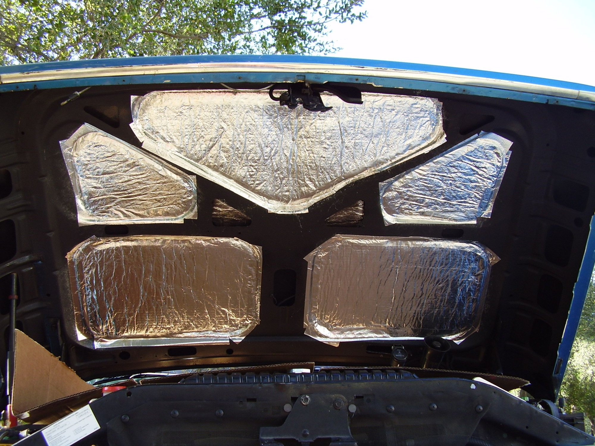

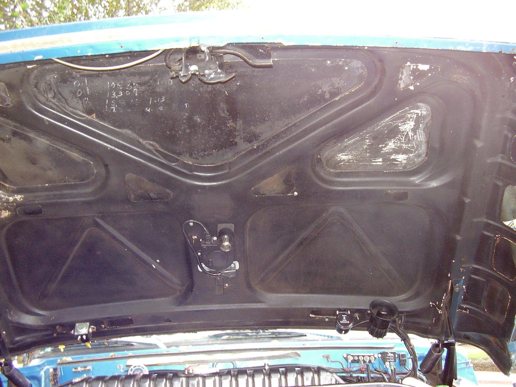

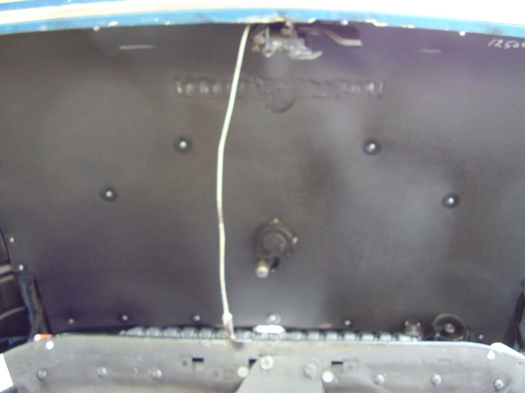

My inner hood was ugly but not from the battery someone painted it with black while it a dirty some peeled. So used a abrasive paint stripping wheel painted it with a black sealer then sprayed with undercoating.

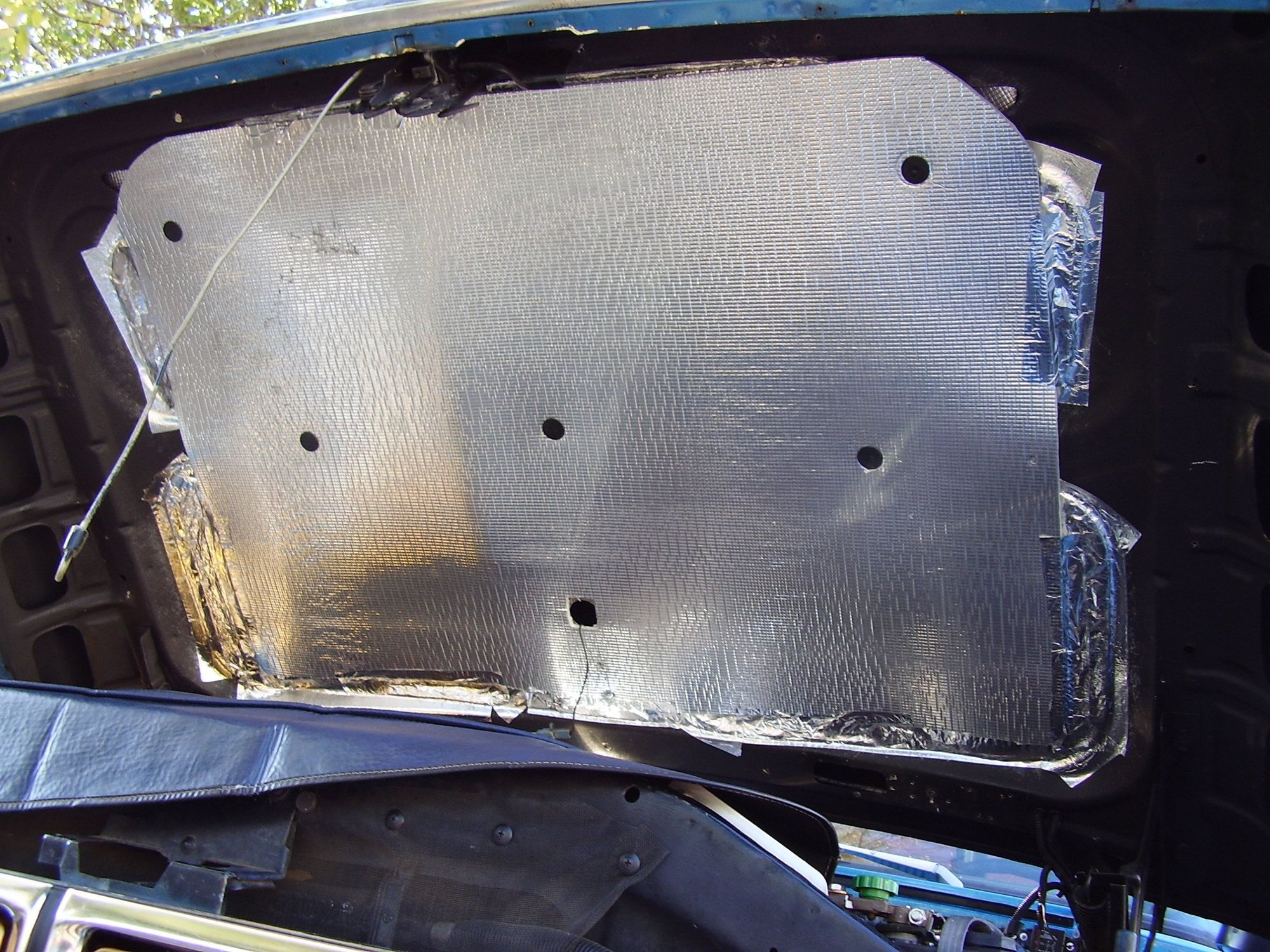

Then added some insulation into the recessed cubicles areas then cover it all up with a thin may be 3/32 thick type plastic covering.
Orich
My large top tank supper cooing Rad top tank stated leaking after a few good hits so cut an opening to relive the pressure on it after having the top tank resoldered
Why so much insulation?~~~~~ well a change of plans after finding the plastic covering.
After buying a roll of thermo insulation at one of the good guys car show.
May be a little over kill but the hood stays cool.
