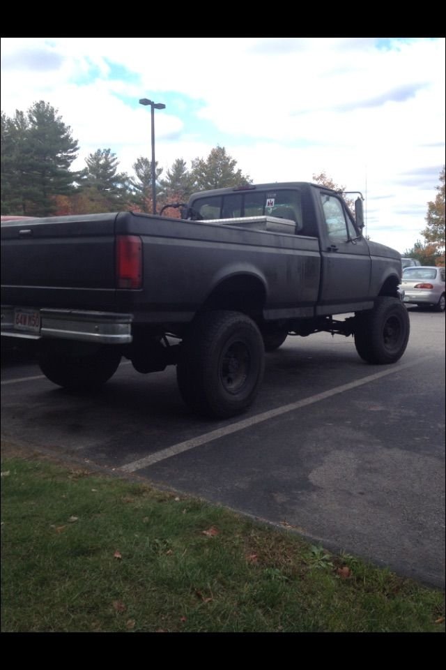

If u can locate some early 70's truck mirrors they work perfect for both of my trucks

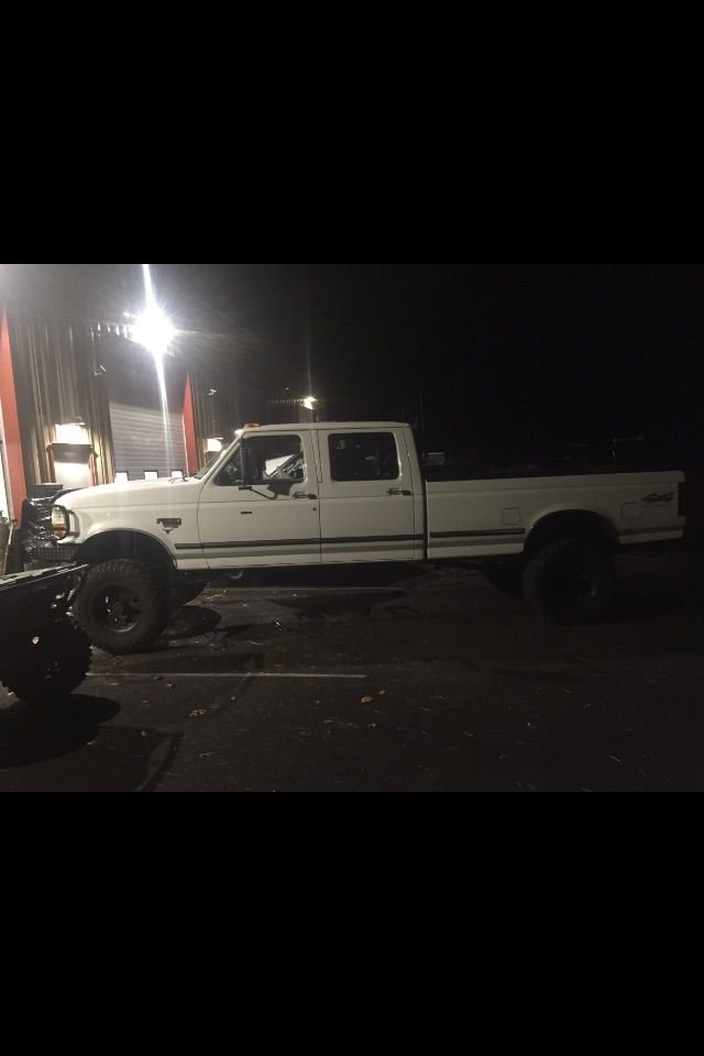

And on my 73' highboy
