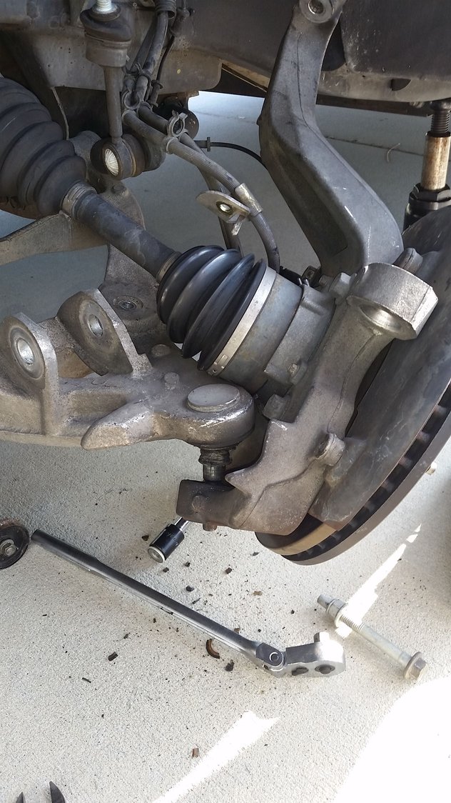

Need some quick help here guys. I thought the spindle would clear the ball joint stud with out removing the axle, but I guess it won't. Do I really have to remove the axle??

Yep, it has to be removed. I see you undid the bolt on the strut, I hope you have a big enough torque wrench to properly torque it. It requires a very high torque

Thanks for the quick reply. It all fell apart so easy with the axle out. I pulled the strut cause I'm doing a Daystar lift also. I replaced the struts about 5 years ago and don't recall what I torqued them to, probably as hard as I could with extra leverage. Do you know the torque value? My wrench goes to 150.

I think the torque spec on the '05 and '06 is 295, but can't remember if that was in nm or lb-f.. I'm also not sure if it's the same on the '03 and '04 but it looks like the suspension is more or less identical
