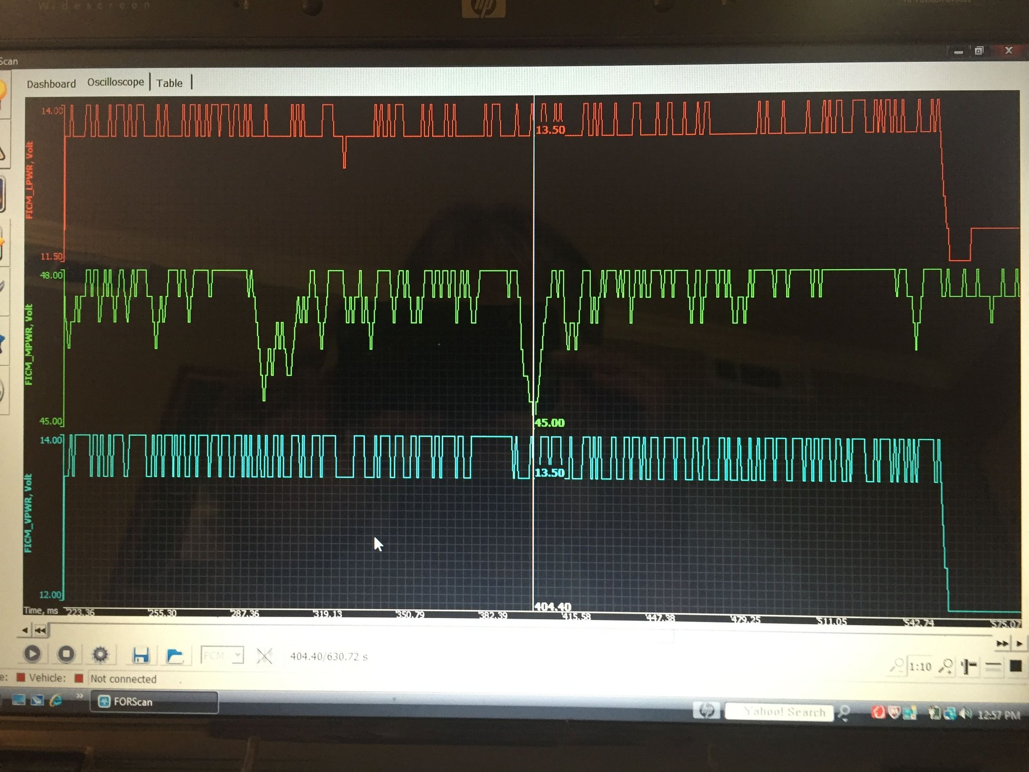

On the ForScan, I've been playing with it today and it does a good bit of stuff but no graphing the injectors while it's running. It will do a buzz test and on my truck it showed fault codes for two cylinders I didn't know was there. If you go to the download site they list a version for Windows, Android and Apple. For the price (free ) it's well worth checking out.
On my truck I also found this for example:
Top (red) trace is FICM logic power, middle is main, and bottom (blue) is FICM vpower. Looks like I'm getting 45v for just a second every two minutes or so with the truck hot. Not ok . I don't stare at the ScanGauge when I'm driving so I've only seen the drops to 46v. Nice to have a graph that nails it. The vertical white bar can be drug around the graph to show the actual number at the point where you place it. Pretty cool.
Anyway, if you have an obdii adapter for your android, I'd give this a shot. A Windows laptop would be better tho, the extra room on the screen would have to make it easier to read.
On the glitch at the end, I flipped the key off to kill the engine and then right back on. Interesting the FICM main power continued to read while the other two dropped as expected.

Hey, not to hijack but what do you think about my fvp and flp squirming around by .5v like that?

Not really sure about why it would do that. Would help to watch it on a
lab scope because it could just be the A/D conversion or the rate. It could
even be real and the system just does that.
