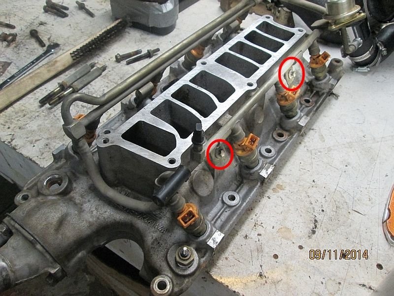

Here's the bolts on my 302, your 351 will be similar.
jim

My 302 used 19s shown in the photo. The old ones had a single pintle nozzle, the newer ones I salvaged from a 90's motor had 4 holes in the nozzle but they worked fine. Batch fire EFI systems are not as precise (and neither is their gas mileage). The O2 sensor is going to do fuel trim anyway in closed loop so disconnect the battery long enough to allow the ECU to relearn the new injector setup.
