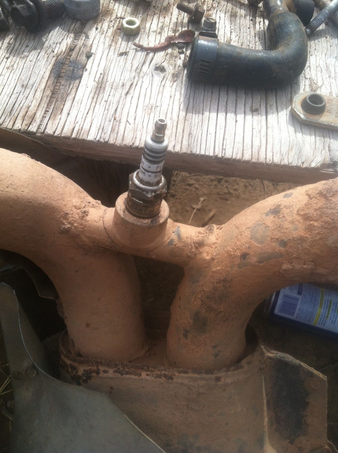

O2 sensor needed plugged it turns out a 390 spark plug fits nicely

I gotta say, of all the things that could of went in there that was one of the least expected of them all for me. Just when I thought I seen everything.
