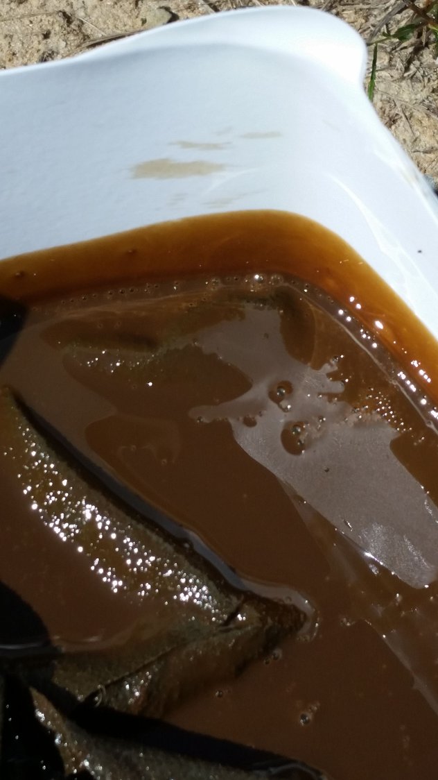

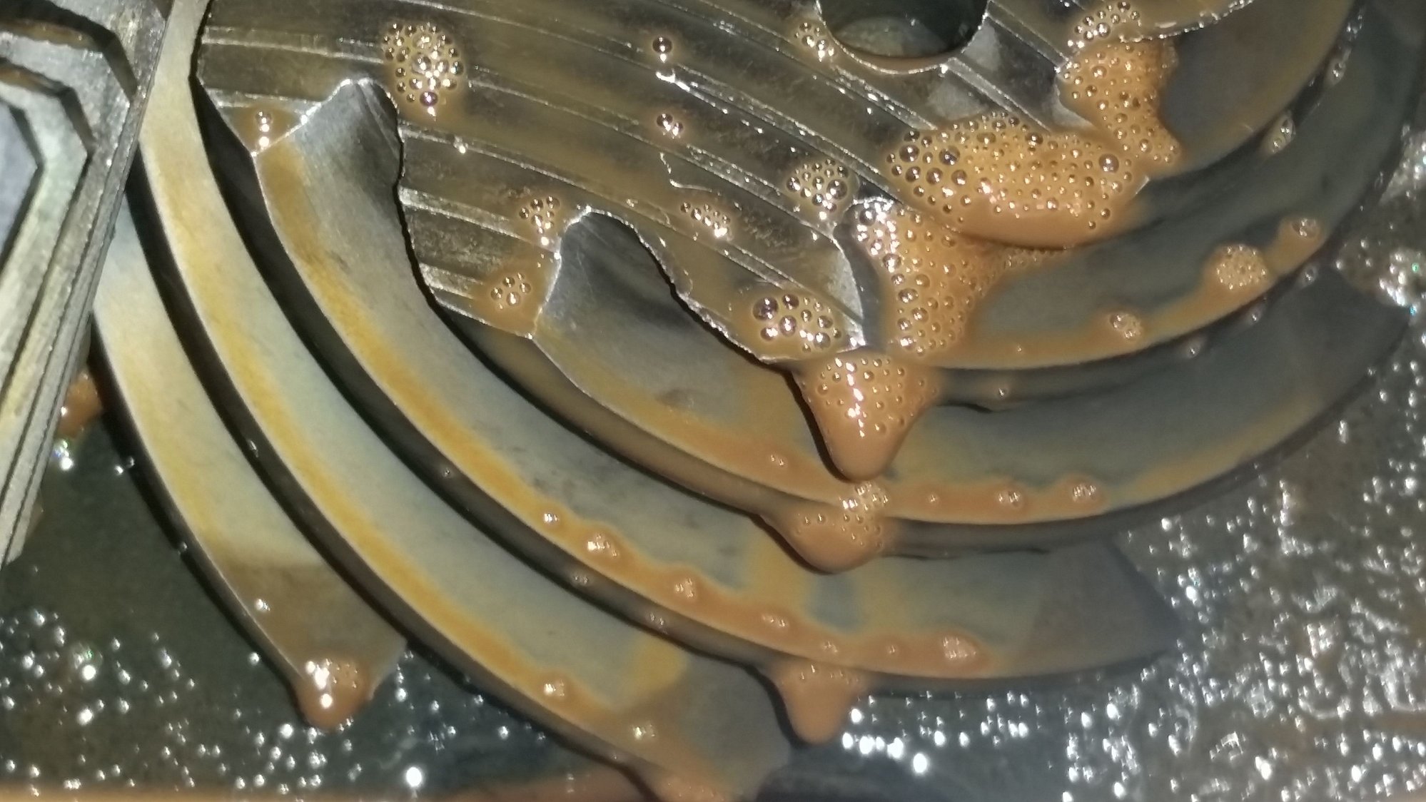

I have a 1984 f150 xlt 302. MY rear diff was making a werrrrrrrr sound on acceletaton.. pulled the cover and found this
Thoughts?

Water contamination. Drain completely, clean as best you can and refill with new gear oil.
