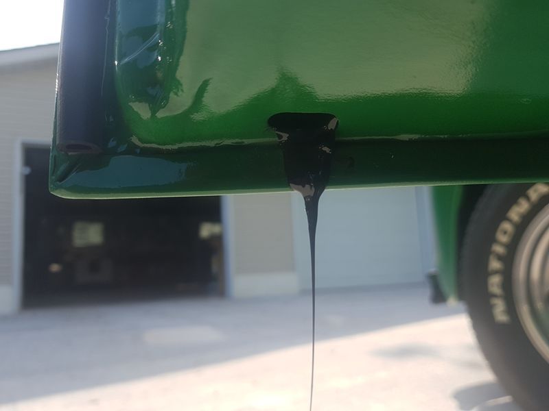

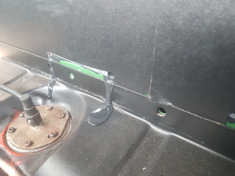

Anyone one have this happen to them. I installed this a few years ago and last year I noticed dripping out the bottom of the doors and cab corners. I took the interior panels off to find this.

Wow and that is not the cheap stuff . I will be very interested in your replies also as many have said don't use the cheap hardware store stuff , spring for the good stuff . Did you use anything else under it or just the Eastwood .

Ive seen another car doing that same thing and it was also the Eastwood stuff.

Spent 4 hours today taking interior out and scraping this mess up. Still waiting to here back from Eastwood.

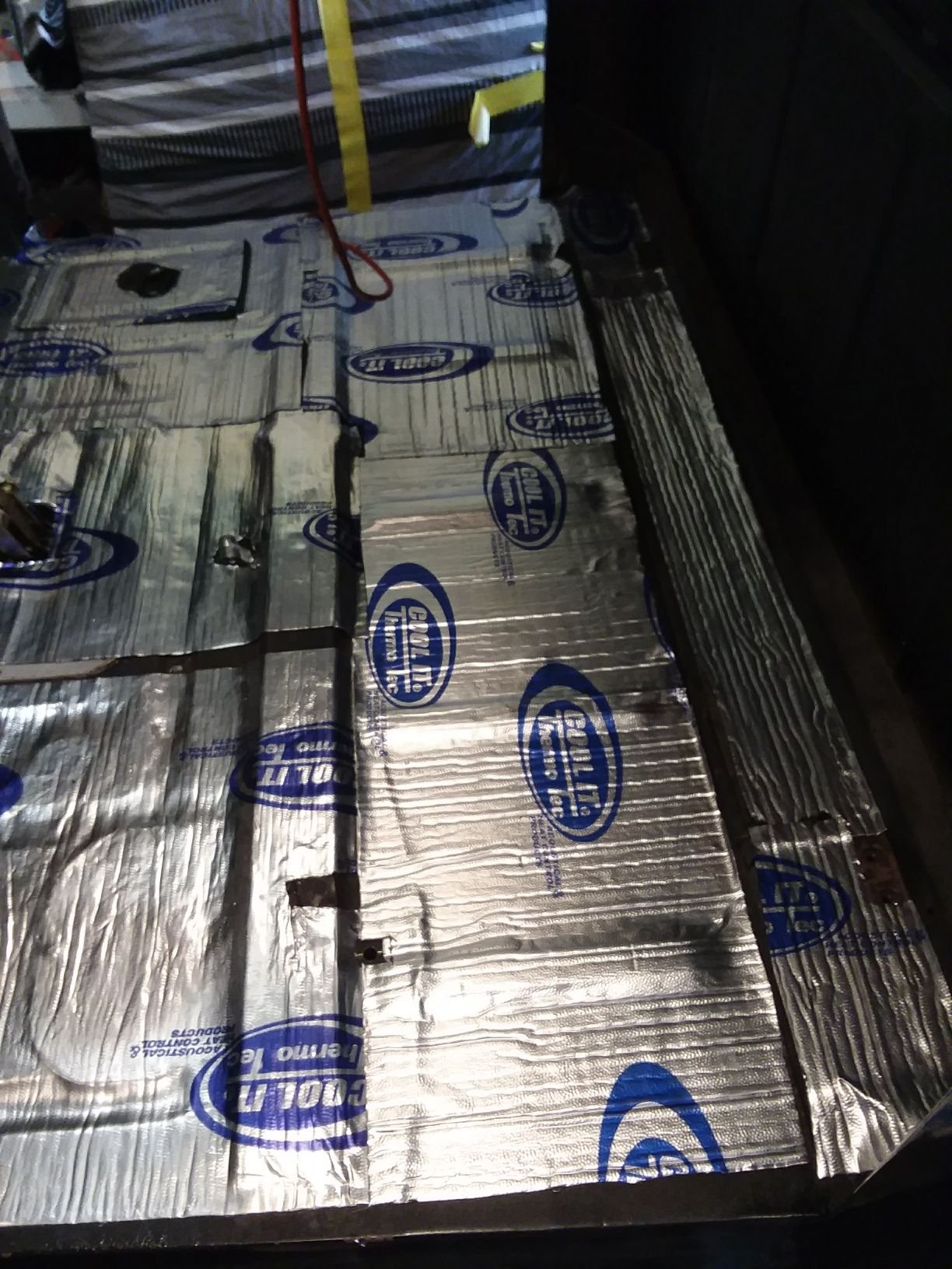

that is terrible and lots of extra work now, the refund money will not pay for your time.-- I always use cool it from sumitt--stick it on and I put my heat gun to it and it forms in all the grooves and never NO problems with it and it insulates

This is not the first time I heard about this with the Eastwood production. I have it in my panel too and heard about it after the fact. I contacted Eastwood and they said I'd have no problems. I did use aluminum tape on all seams and haven't noticed any drippings. I had a few sheets left over and installed it in my pickup at the sides of the rear window and hadn't put the aluminum tape to seal the edges and noticed the same problem. I would never use it again and like it was mentioned it isn't cheap regarding the price of it..

I would be concerned with any headliner - panel that is a paper material as the tar on the mat is almost certainly a petroleum base and will bleed though any fiber material .
