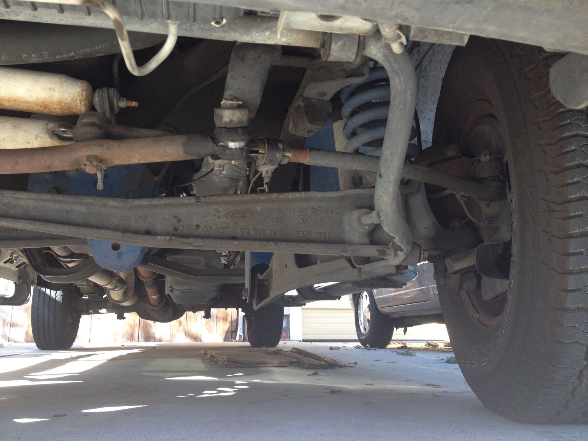

6" lift and 3" drop on the pitman could be part of the problem. Do you have a photo? How do your tie rods look? Are they at a steep angle and bound up?
Old Oct 11, 2015 | 08:52 PM
8 burnin 2 turnin's Avatar
8 burnin 2 turnin
Joined: Mar 2009
Posts: 62
The angle from driver's side to the middle rises up a bit. The gear box is way up there and that arm looks shallow. But if I go with a deeper arm, the forces on the box get bigger. That's why I was asking if there is a kit to drop the box itself. Or how about those oversteer kits? Move the tie rods up at the knuckle?

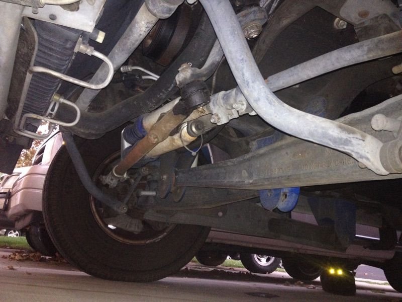

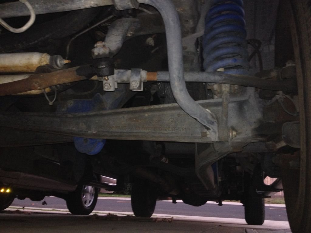

Does that tie rod not look bent to you?
TTB fords are a magical system, but if the magician is not careful he creates a death trap.
Your angles don't look to crazy but its hard to tell from pictures.
Either way for the size lift you have you shouldn't have steering component failure if done correctly. Lowering the steering box wouldn't be on my list of things to do.

Looks like the one they replaced last go-around. But yeah, they do look a tad strange...

Here's a another shot. I just realized they didn't notify me that I had a bad boot.... geeez.

I meant to get a picture of mine tonight when I got home but forgot.
But looking at your second picture, your lower stabilizing shock is rubbing. The force of that collision is likely the biggest issue behind your wear.
Look at the dent in that thing. I'd remove that lower shock and see how it feels.
Ding ding ding, another whammie. Good eye.
