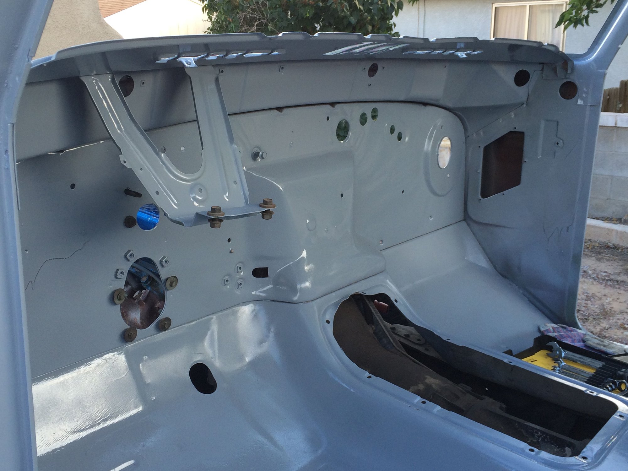

So I managed to score as close to perfect rust free cab from a 74 f250 to replace the cab on my 78 f250. There was a lot of rust and oh ya the home made sun roof that was installed with roofing tar. I have no clue what the po was thinking. The wiring has been a constant problem for the 6 years I've had this truck so I decided to go with a Centech harness from what I've read here.
Jim is awesome to deal with. We talked for about 20-30 minutes and about a week later there was a box at my front door made for my particular truck. He added wiring for the electric fuel pump and the electronic control module. I also went with a HEI dizzy and one wire alternator. The cab swap was easy and the hardest part was cutting the cab bushings with a sawzall. Cab dropped on and bolted down with new bushings and hardware.
I started the wire harness install yesterday and have a quick question. Where the ignition switch wires attach to the fuse panel are some threaded lugs and the wires slip over it and has a nylon lock nut to secure it. Should I solder this connection? I'll try to load a picture also.

This is what I'm thinking about soldering together or should I tighten the lock nuts down and call it good

Yes he includes the solder, heat shrink and all the connections needed. I believe there are some extras in there also. I can't say enough good things about working with Jim. He asks a lot of questions and has a ton of helpful advice. He uses all the original ford connectors and supply's the head light switch. His harness was a strait plug into the wiper switch and factory steering colum switch. The length of wires is plentiful also.
I scuffed the cab and put down a few coats of epoxy primer. It went on nice and thick and dried with a little gloss to it.

A pic from the start

hey sparty ,by the pics it looks like in original location,not that i want to answer for the op but that what it looks like,Im a couple of weeks away from starting mine although i did receive setup from centec

Hi,
its pretty close to original location but I moved it a little higher and closer to center. I have some aftermarket gauges and the wires couldn’t reach it in the stock location.
