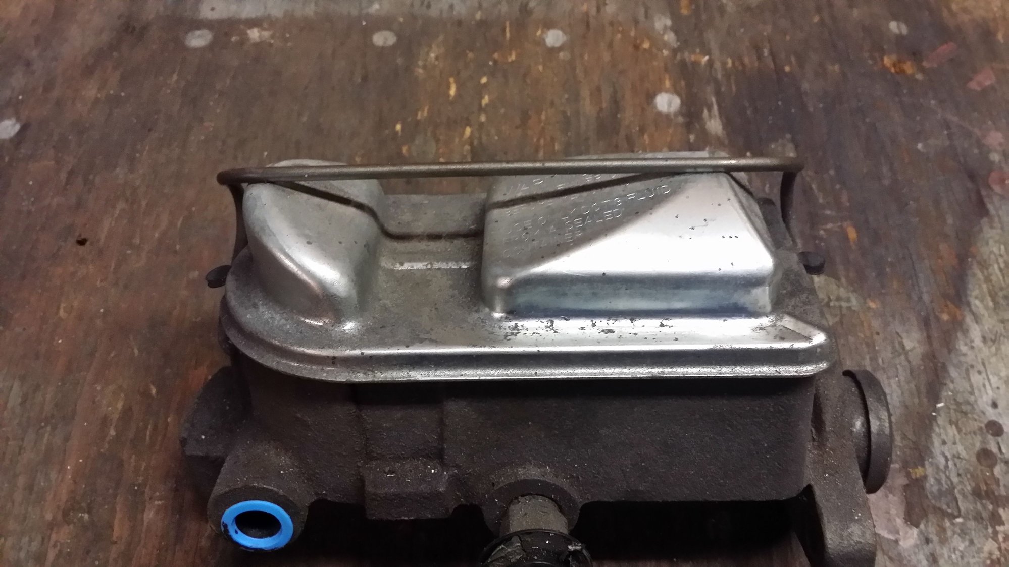

Some Ford MCs have lid vents some don't.
Vents present in lid.
No vents present in lid.

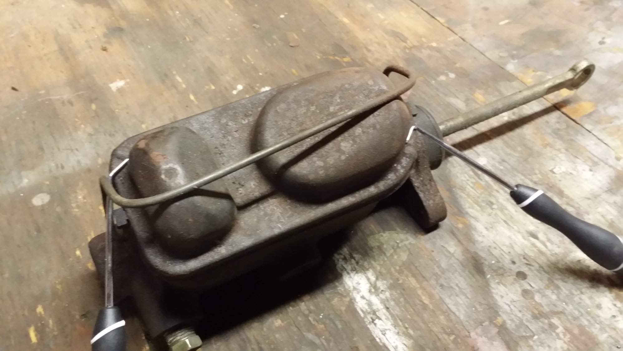

I went back out to my shop to take a closer look at some of the old conventional style Ford cast iron MCs I have in a box.
The lids on the MCs that didn't have obvious vents in the domes still have vents in them.
This is the lid that came off the cast iron MC I had put on my truck, prior to installing a modern cylindrical aluminum body/plastic reservoir MC.
Notice the raised stamping in the lid (the areas where the three picks are pointing to). These are air channels to allow atmospheric air to the topside of the seal.
The air enters into the channels from these two places on this lid.
This is the crusty MC that was on my truck when I bought it. No obvious vents on the topside of the cap but, what do you notice where the picks are pointing to?
