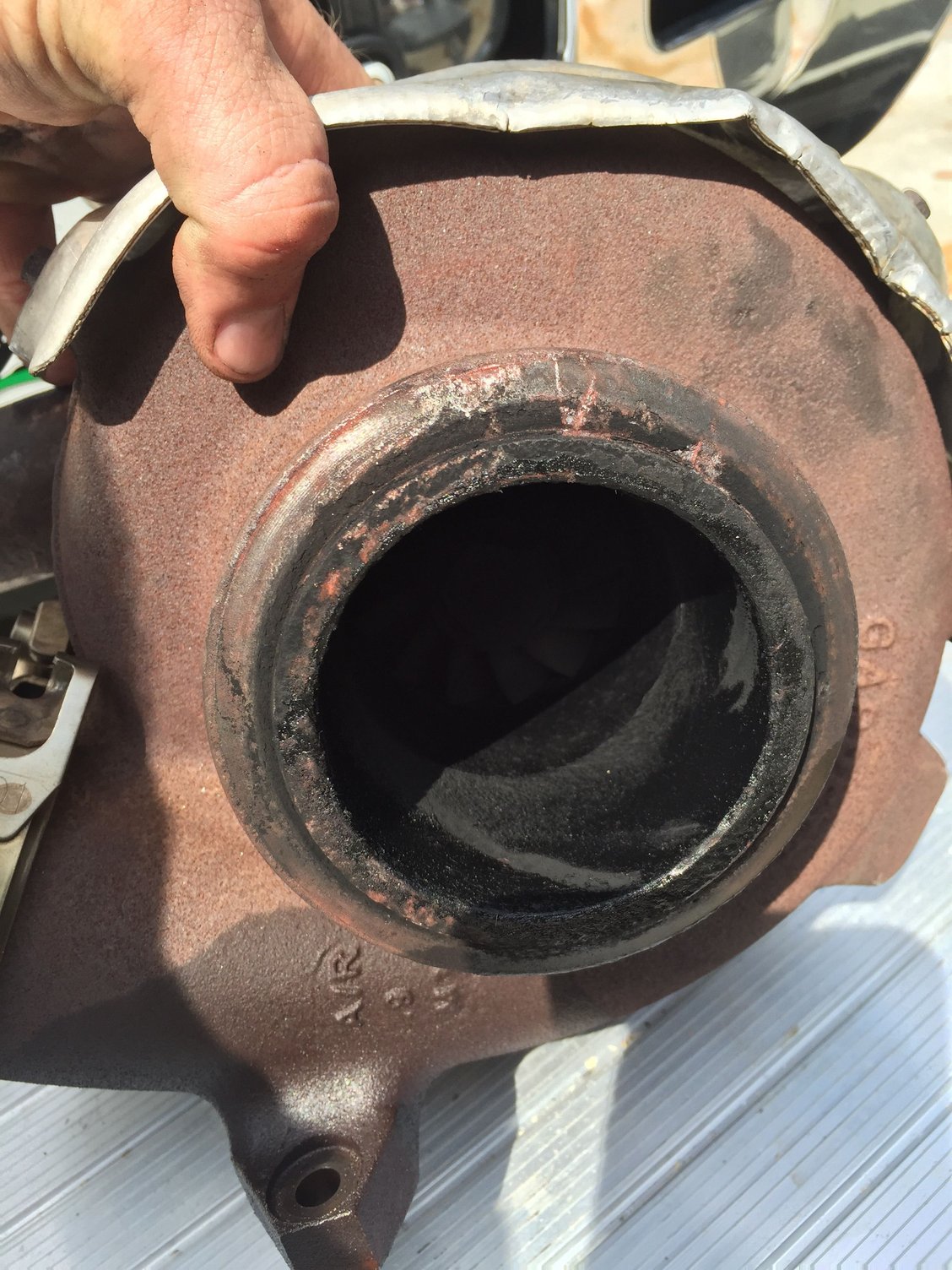

Would there be much oil in the down pipe if the oil deal was leaking on the turbo? I broke it loose to look at it and not much there, one small area that looked like it has had on it

you need to look the other direction,
inside the turbo. Maybe use a mirror if you can't directly see in that direction.

Should expect to see a swirl inside the pipe.
Could also loosen the downpipe to cat/delete connection and look for pooled oil there.

There is some oil residue in it. How much would be in there?

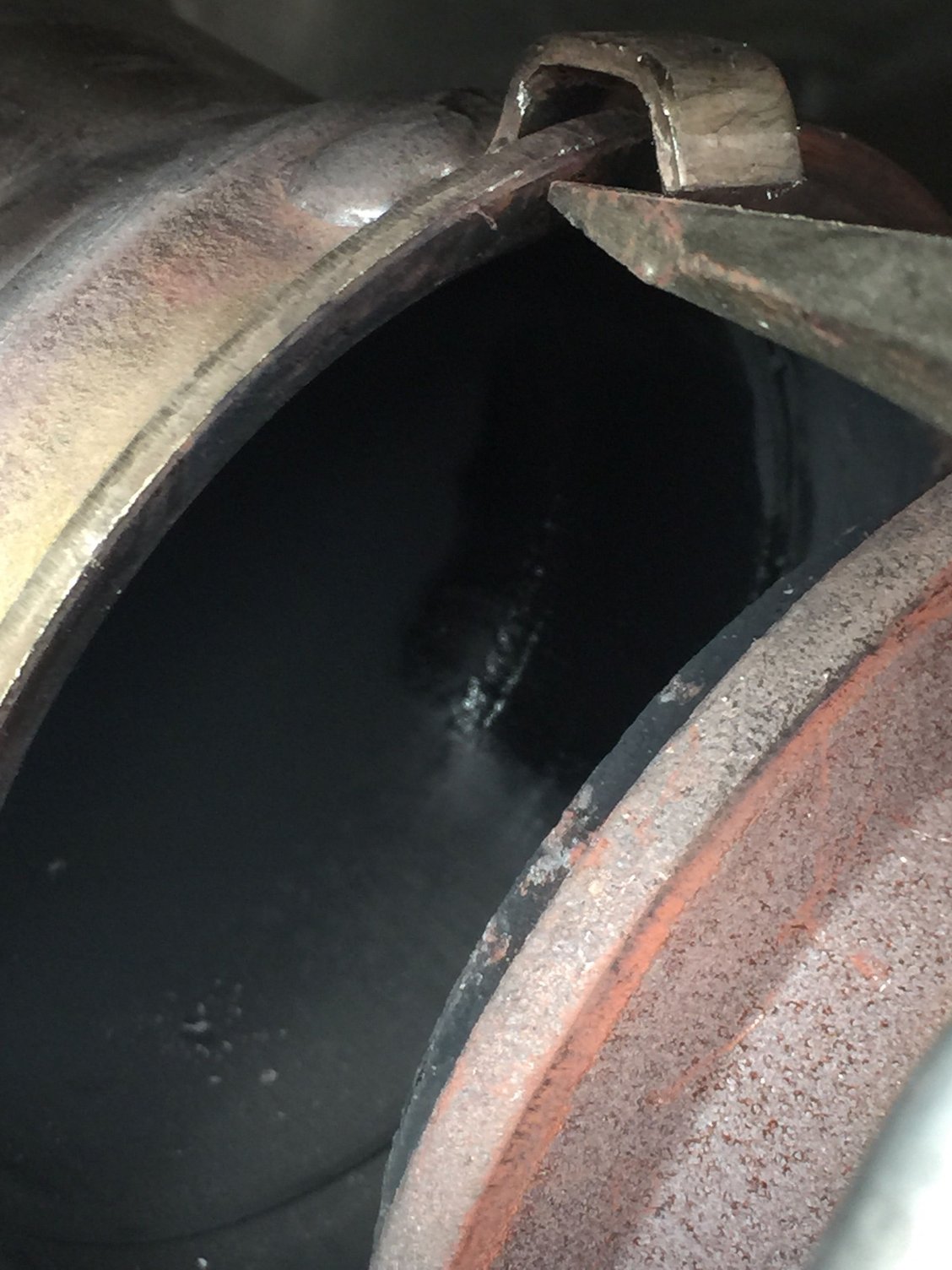

Is it smoking? Start-up or smoking after reaching operating temps?

Smoking after warm at idle at stop light, puffs out at acceleration then is clean until next stop. Runs smooth idles smooth all temps are good, plenty of power, nothing wrong except the smoke.

Yep, turbo shaft seal is toast.
Rebuild kit is about $100 or a new Garrett turbo is about $800.

Is that what the turbo would look like leaking oil?
Yes.

yep, you need a turbo seal.
turbo rebuild guide is in the tech folder if you need some reference.

Thanks for the help! Just ordered rebuild kit, the updated feed tube and drain tube and went ahead and ordered the blue spring upgrade! Next day shipping to!

Rebuilt the turbo today and put it in! Cranked it up and it runs like a champ and no more smoke! Even sounds better spooling up! Thanks guys for all the help!!!
