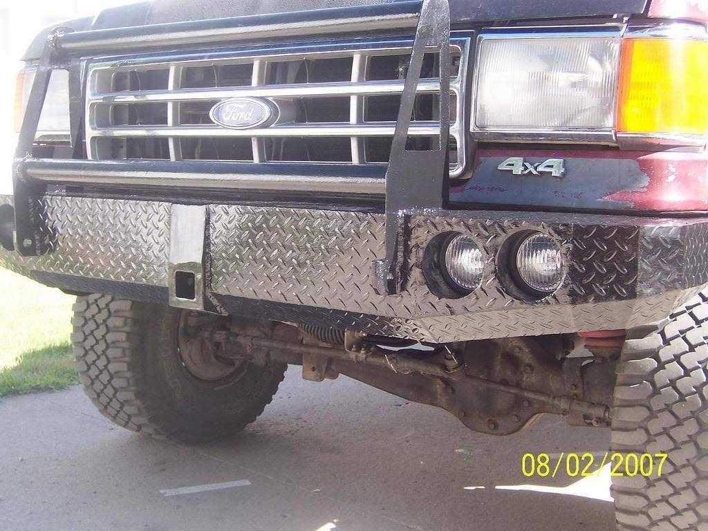

This is the bumper I am building save for a few changes I am making.

Originally Posted by rangernut09011980
Where does the pin go for the front receiver? Not much use without it.

No idea on the hitch pin. This picture is from a build thread from elsewhere on this site. I am planning on copying it but I am using smooth plate Ave probably going to switch from the hitch to winch as well as a pair of 6 ton winching shackles that will be mounted into 1 inch steel plate that will serve as the frame mounts for the bumper
You can see light through the hitch pin hole in the picture, so it's there. Probably can be accessed (but not easily) from underneath. But you don't need to access a fron hitch pin that often, so that's probably OK. (I did a similar thing on my Bronco)
