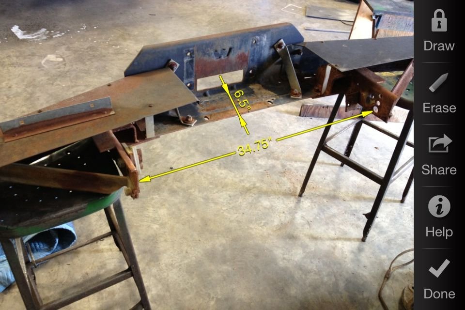

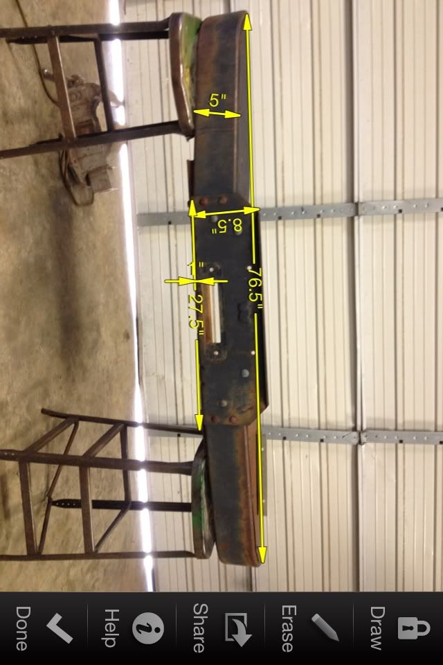

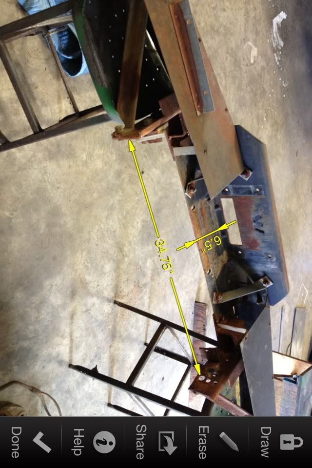

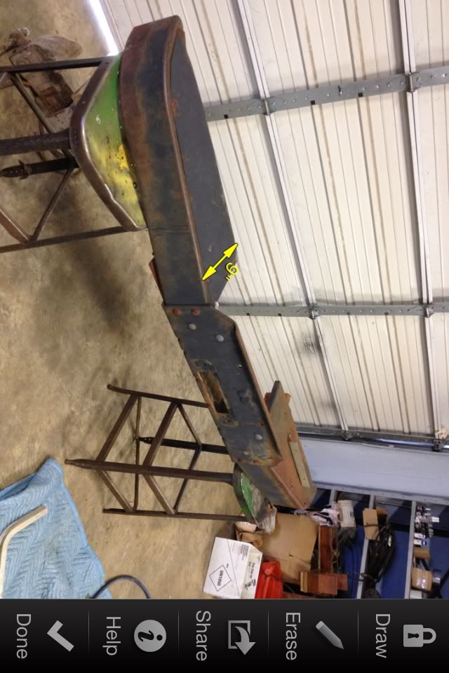

I have one of those, I don't have the dimensions for the chrome on hand, but I do for the bare metal finish.
I think this particular bumper came off a 70's model so the frame bracket dimensions may not be the same.

Yeah, looks like a slightly different model as the end corners are rounded whereas the one I had were a sharp turn, but close enough. Thank you very much. Just one other question, what's the material thickness?

The winch mount is 1/4" the side pieces are think sheet metal, I braced it up before I mounted it on my 79. I ran a chrome bumper identical to the one you sold on my 79 a few years ago, so these dimensions should be close, I think the chrome bumper is an inch or two taller.
I braced the top by taking off the thin sheet metal and welding on 1/4 diamond plate. This made the bumper far more rigid.
