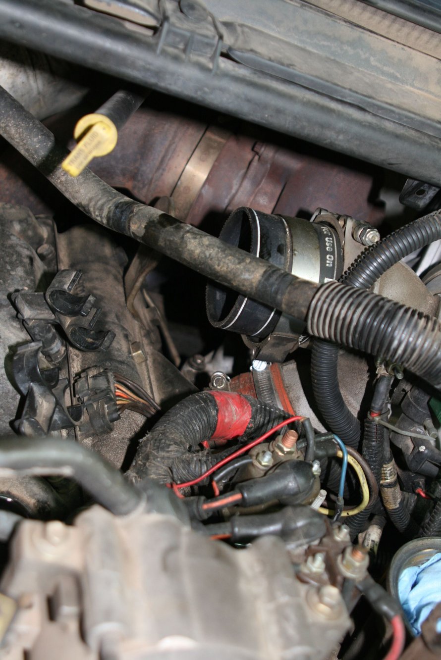

Wyatt,
My 7.3 was a 2001.
This is the best pic I have of the relays. I sure somme else will post a better pic for you but this might help you get started.
