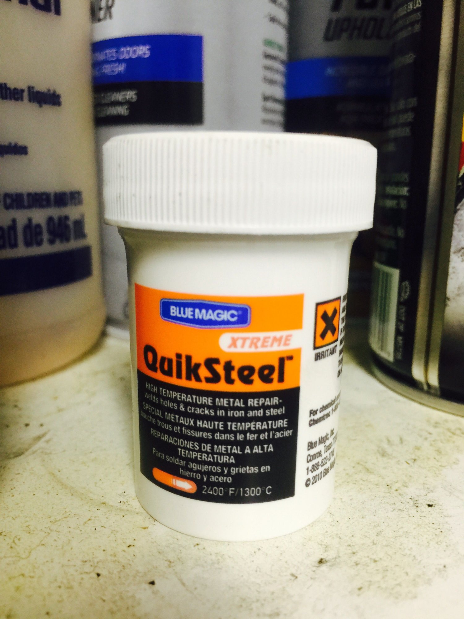

I had a crack in my manifold. I drilled 2 1/8" holes at the top and bottom of the crack to relieve the stress, used a grinder to apply a bit of a surface, then used this stuff. I had the truck for about 6 months more before I sold it, and no cracking.
