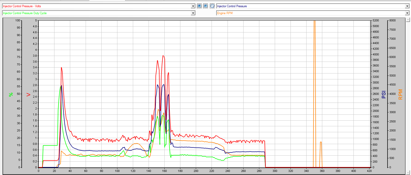

So here is my data run. Ambient temp was about 65, the truck was cold for this start. I started it up and drove home, doing a WOT run through a few gears.
I apologize that I don't have EOT on the graph and I also apologize for the scaling on stuff, my computer is being a pain. If I need to adjust the run or something to zoom in on data, let me know.
Ignore the huge RPM spike, computer connection issues...

After taking some time to look this over, this whole issue may be the result of a worn or dirty IPR. I would suggest dismantling, cleaning and re-sealing and see where that get's you for $20.
Question: When coming to a stop, or a turn where deceleration is necessary, does the RPM drop to say 500 RPM's and then return quickly to 650 RPM's. If so, seek the IRP prior to dropping cash.

I bet you're on to something with that IPR, it behaves exactly like you describe if I drop the engine to idle real quick. Does anyone have a link to instructions for a full tear down and cleaning of that guy? I know I've seen a thread about it before but I can't find it for the life of me...

When you play back a file, you can configure your mins/maxes to anything you want for better scaling. You can then zoom in with the magnifying glass to change the amount of time shown on the scale. You can really tighten it all up with a few clicks while loading the file for playback, and while viewing.

Rich, that's what I thought at first as well, however ever since I can remember, the truck has always idled at that low of DC. I have had 3 different (2 known good) sensors in the truck and they all give me the exact same readings.
I will agree my truck feels somewhat anemic, power wise, but I don't know if it really is or if that's just how it seems, seeing as I have never had another stock truck with the zf6 to compare to....
I apologize again for the scope of the graph, AE is on my school laptop and they were doing a bunch of updates through the system and my laptop was doing good to upload the picture.
