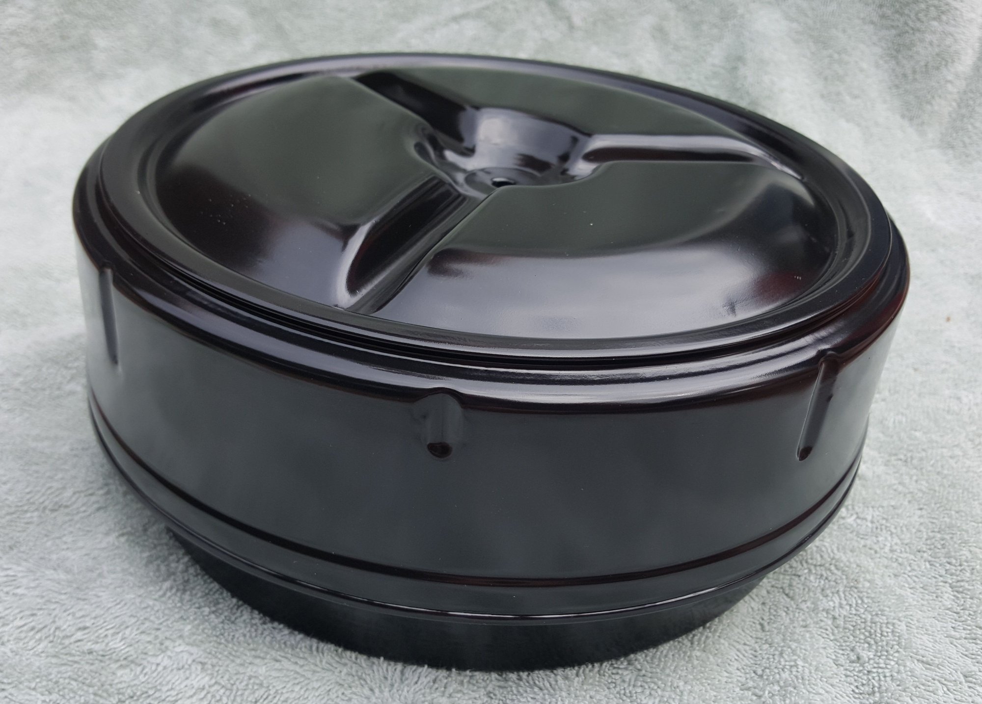

I refinished the oil bath for my 240. Just one thing complete on an extremely long list of things to do.

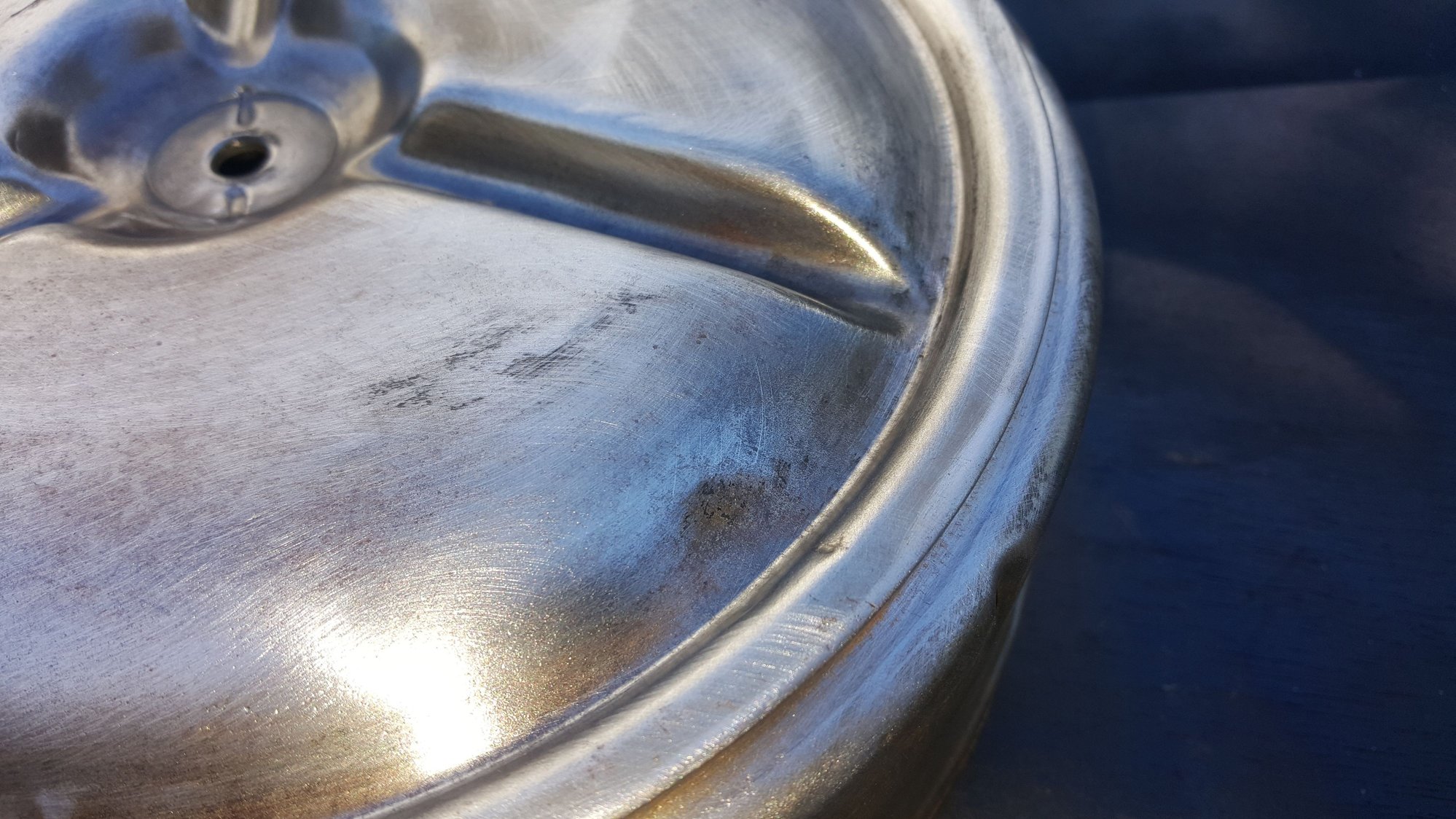

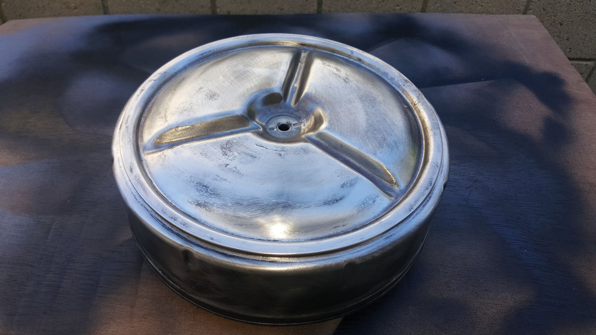

Steps 1 through Done. I stripped the paint with a wire wheel, body filled a small dent, sanded with 220 then to 400, primed with four coats of etching primer, painted with automotive semi-gloss black paint, wet sanded the orange peel, repainted, wet sand, repaint, total of four coats and applied the I6 240 - 150 decal purchased from The Truck Shop in Orange Ca.

looks nice!

Very nice work.

Wow, that looks great! Makes me want to refinish mine, but a nice air cleaner like that would look pretty out of place in my engine bay!

Thanks guys, It was a pretty simple and rewarding project.
You should do it Inline, make it the one thing that stands out.
