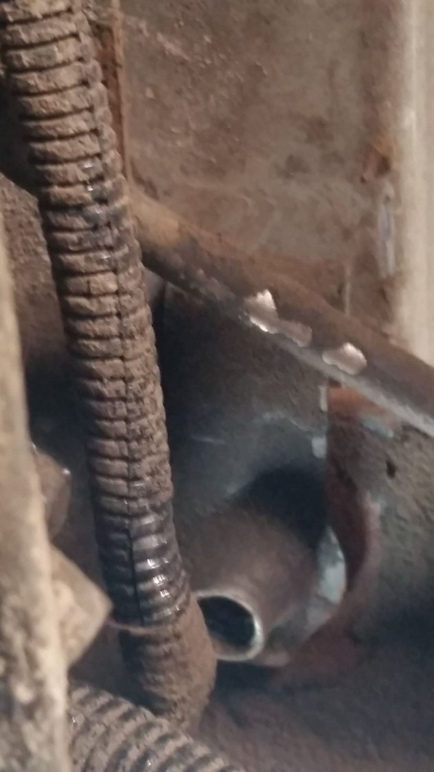

Sorry I trashed the bolt pretty well taking it off. It had a very large phillips head I tried using an impact driver to get it to move and when that failed cut a groove across the head and used the chisel. I took a picture of the clip I removed and got the carriage bolt to work.

Man, you made that bolt look like a piece of convolute tubing!
Seriously though, the "clip" looks like the bottom end of s captive sheetmetal nut.

That clip looks like ones they use on the bottom of the fenders in the rockers.
Think the spare tire holder uses that same kind of clip too.
I think your took box brace uses that same type of clip.
