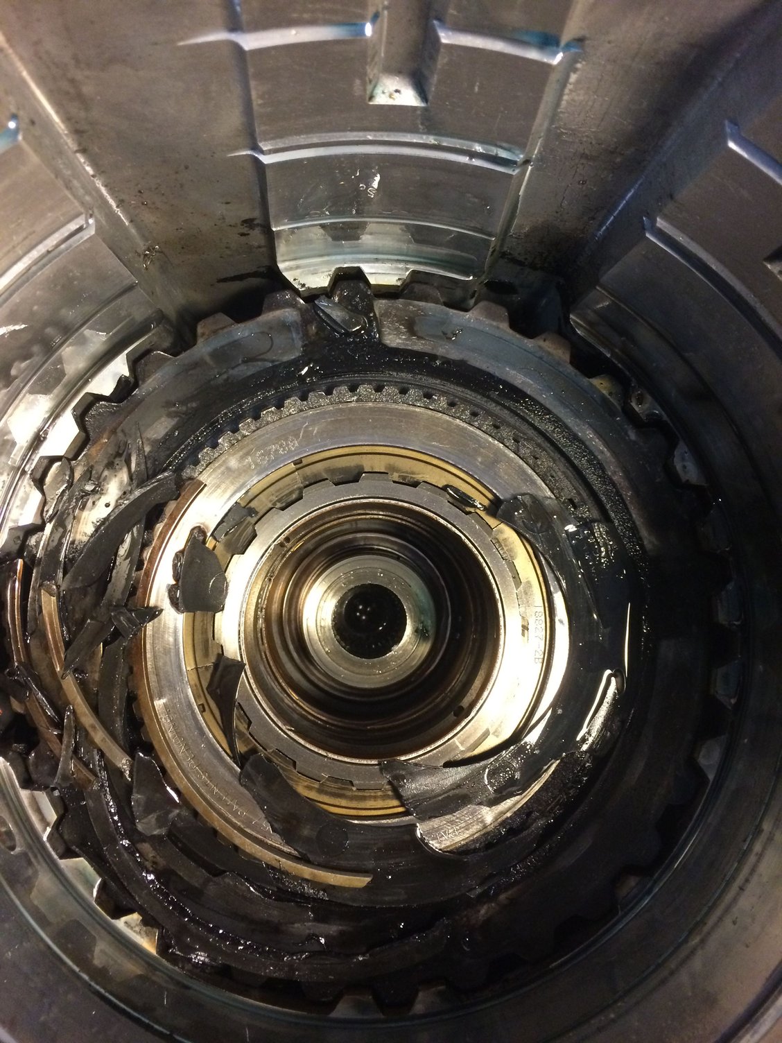

Alright so I got a little time today pulled the trans down. Took the torque convertor out just to see the damage. I put the shaft in and it is completely locked up. Drained all the fluid from the trans and converter both are dark red almost black.
So where I'm at now
I will be getting a new torque converter for sure. And possibly a rebuild kit for the trans. Not sure of what it look like inside yet. I have yet to see any chunks of metal so that is good I suppose.

I found an issue.

Yep, that's a problem alright
Good that you found it. Now to see what you do about it?

I think it's time for a rebuild. And a new torque converter.
1,2,4 and over drive all looked good but 3rd is gone. There is also a bearing that was trash so it may have caused the destruction there.
The torque converter is locked up solid so I'll have to replace that also.
