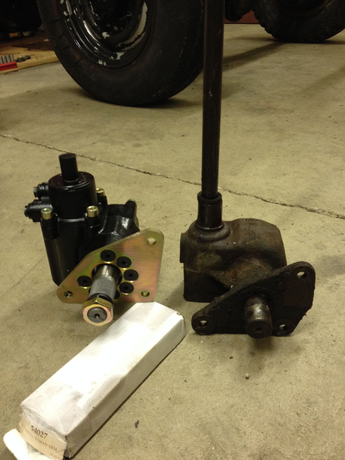

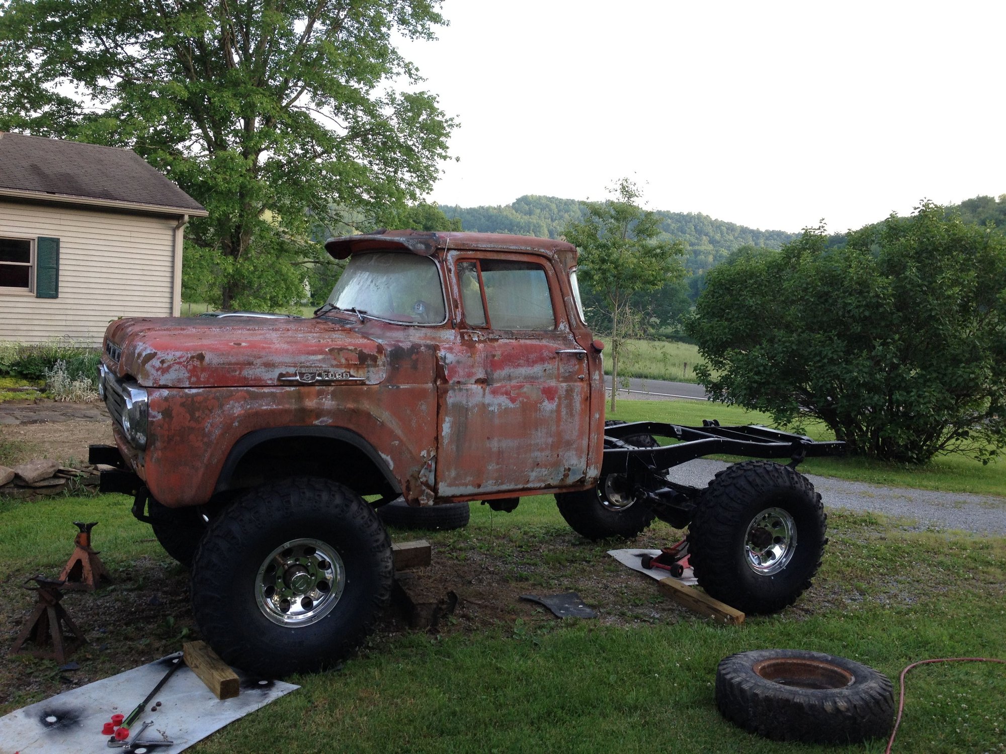

Hello all, I'm a new guy around here an wanted to share some pics of my long term build...I bought this '59 when I was 17 from my uncle for $500, it has a '66 462ci MEL (mercury,edsel, Lincoln) with the matching C6...it retains the original spicer 24 transfer case...I swapped in a set of locked Dana 60's from a '79 F350...Installed CPP's power steering kit, new wiring harness, and power brakes...still a work in progress

I'm subscribing! You are going to like the power steering with extra large tires, I know my elbow smacked the door too many times before PS. Like you I bought my truck when I was 16 (1970). That Dana 60 front end will have much stronger spindles/knucles, not to mention axles.
Good luck in your quest!
Old Jul 31, 2015 | 03:24 PM
kujo3692's Avatar
kujo3692
Joined: Jul 2015
Posts: 139
From: Wild and Wonderful WV
thanks teddy, love your truck by the way...I knew I was gonna need PS with the 39.5 inch Iroks...I figured the closed knuckle 44 was strong but I didn't think it would take the abuse of the big tires...I went through and put new dual piston calipers and crossed drilled rotors (if you can move it your gonna have to stop it eventually!!)....I sold the old set of running gears to a friend...ill have to post some pics of his truck too...we chopped the frame on a cherry, barn find 53 F350 and put them in!! its bad a**!!

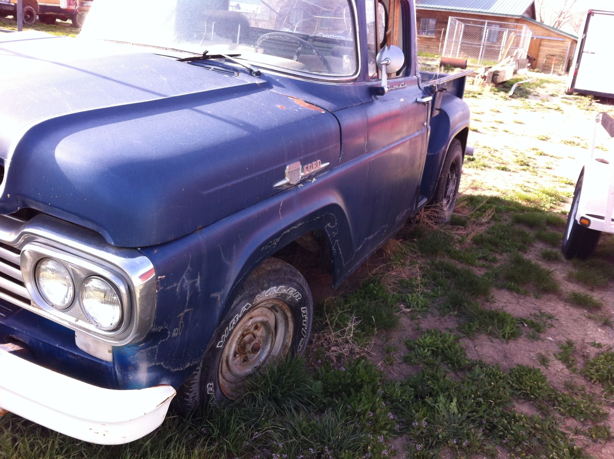

I need to go back to Wyoming and pick up my parts truck!

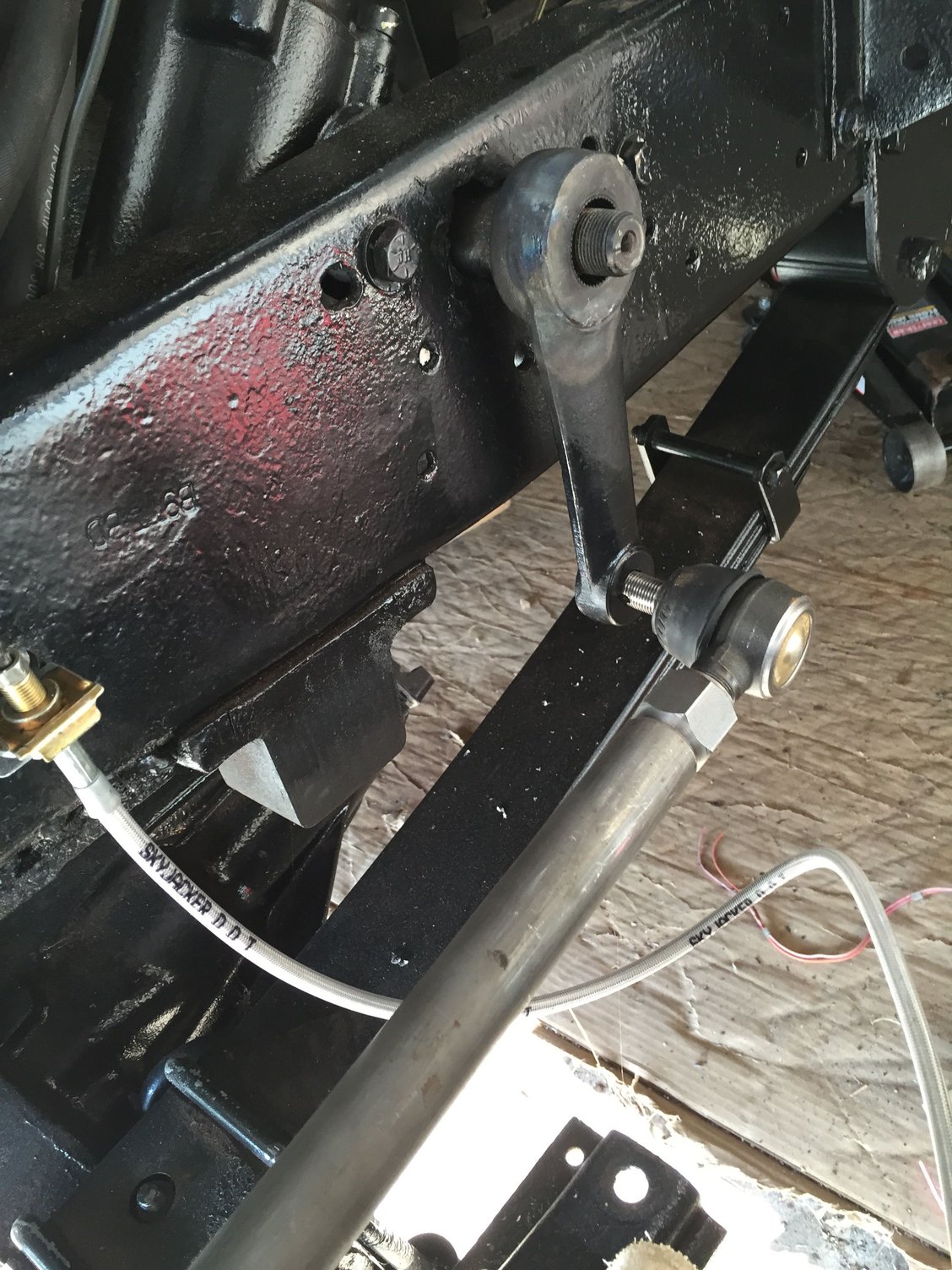

Old Jul 31, 2015 | 10:53 PM
59 shorty's Avatar
59 shorty
Posts: 218
From: Bonny Lake Wash.
How about posting a picture of the pitman arm. It,s the last part I need to finish my power steering conversion.much appreceated. Mark
Old Aug 1, 2015 | 09:28 PM
kujo3692's Avatar
kujo3692
Joined: Jul 2015
Posts: 139
Toyota pitman arm that came with CPP's PS kit...due to the axle swap I have to make my own drag link(still need to do that)
I bought a kit from WFO concepts that utilizes big chevy tie rod ends to make your own drag link..it uses weld-in bungs and D.O.M tubing...due to the different taper on the ends, I need to take the pitman arm and steering arm from the axle to the machine shop for reaming...its my last step to finally completing the axle/PS swap
