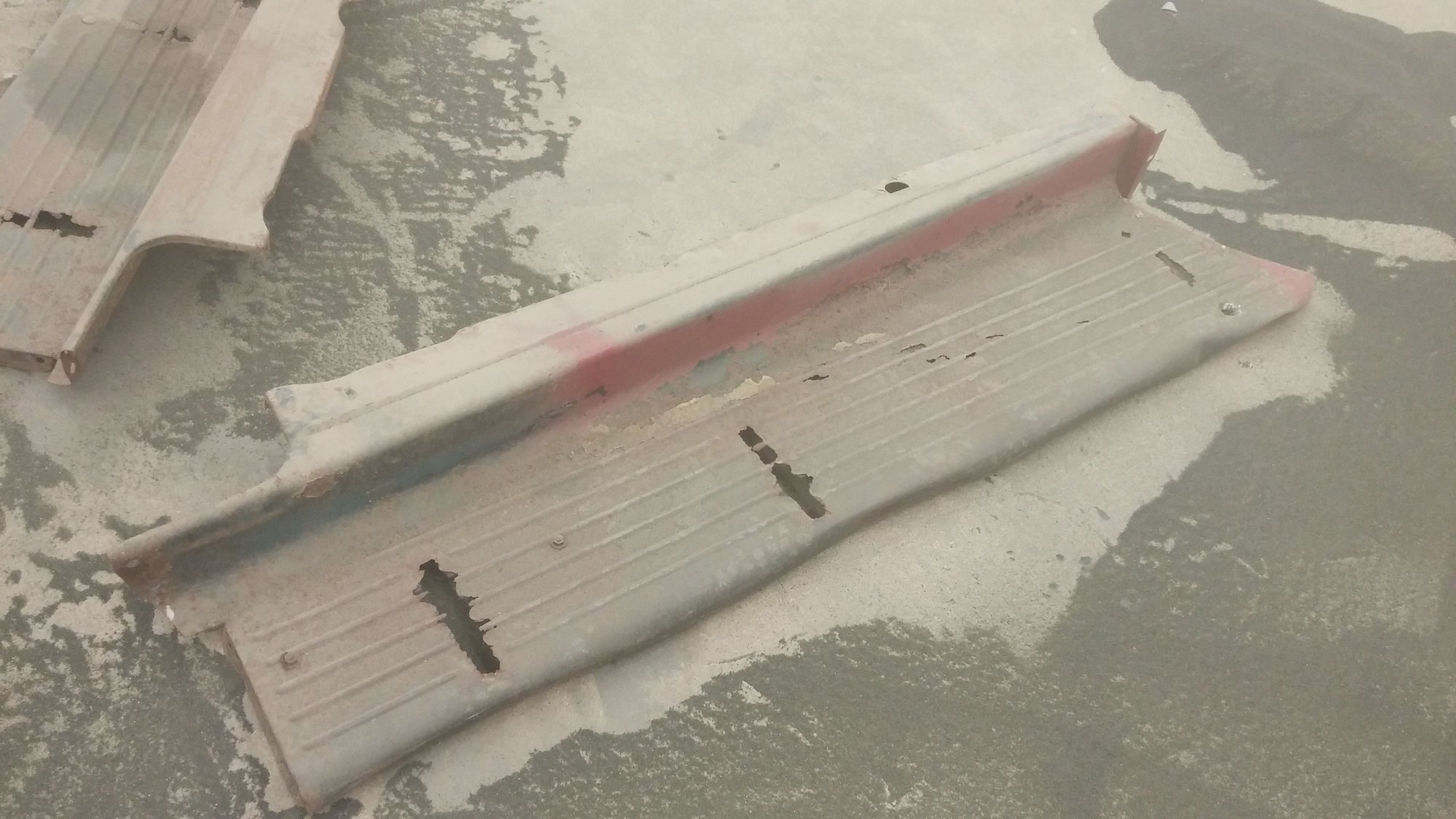

Thanks for the compliments guys. Really enjoying working on this truck. It is all I want to do even on the weekends. Another quick update. Got the motor in for what I am hoping is the last time. Got a few pictures of the running boards on the truck and a couple showing how much I replaced. Plans for this week are to hopefully crank and run the motor. Finish welding running boards so I can get the bed, cab, and running boards on for the final time. Hopefully will start wiring end of this week or early next.

Thanks again guys. Got the motor running, seems to idle well. Unfortunately the previous owner of the motor cross threaded where the fuel line goes into the carb. Was able to find one on ebay for $45 though and a rebuild kit for 30. Got the running boards and tailgate in epoxy primer. Getting a throw-out bearing tomorrow morning and going to start running exhaust. Not long and I can start wiring. I will also post a video with the exhaust finished.
