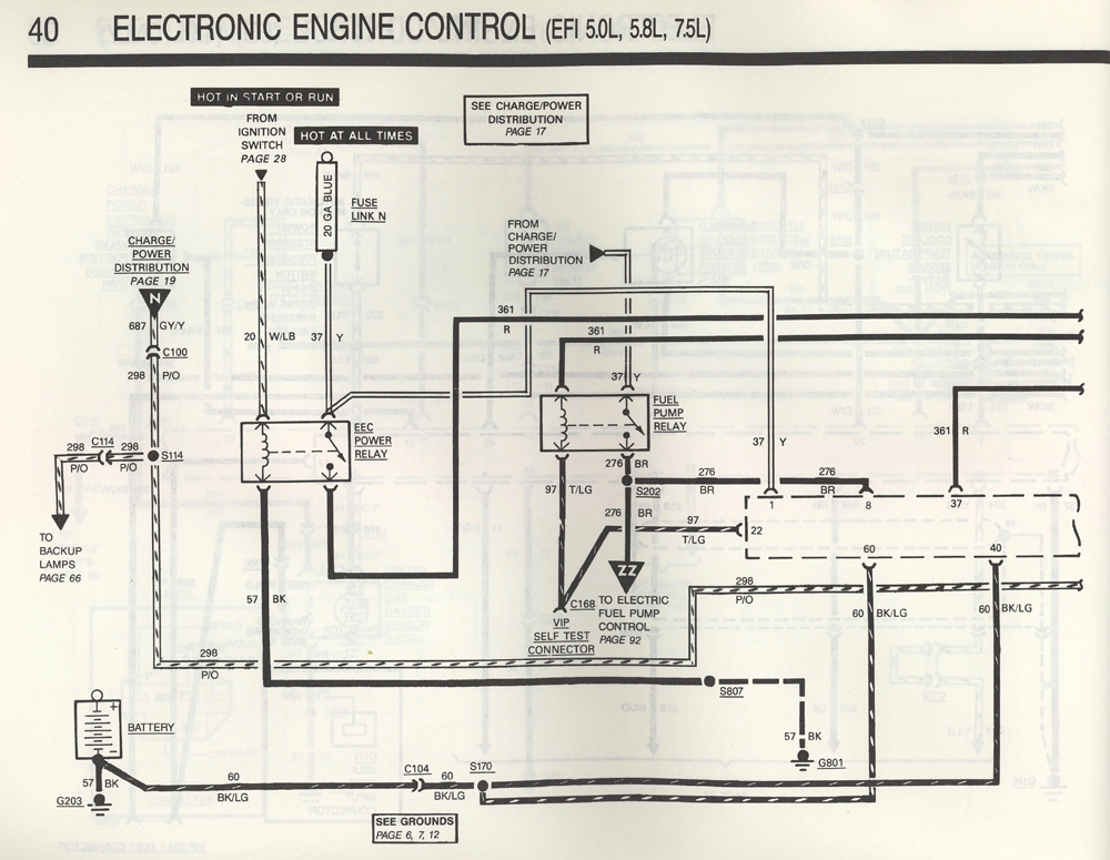

Sounds like you have an open circuit from the EEC Relay to the Fuel Pump Relay. When the EEC relay is energized it provides power to the Line side of the Fuel Pump relay coil on the Red wire.

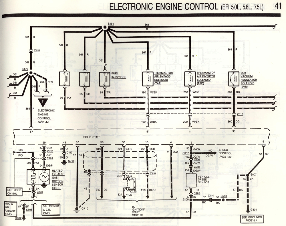

These two diagrams may help:
You should have +12 VDC at the coil whenever the key is in the Run or Start position.
For reference:
