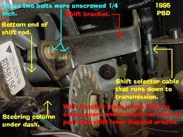

also be sure these bolts are tight.if not,remove them and put some red loc-tite on them and snug them up;
