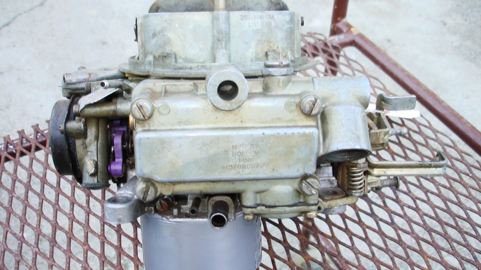

This is not a pic of my carb but it is a picture of the same year model. As you can see, the idle mixture screws are different than on the 1980 and up 4180 models. They are still in the baseplate but they're much more easily accessible and you can actually see them without contorting yourself like a circus freak .... plus a flathead screwdriver is all it takes. I am liking this part of my rebuilt carb a lot

Here is another angle .... see how easy it is to see the screw on the left? The one on the right is also fairly easy to see if you are facing it just off angle to the right ... it isn't as hidden by the accelerator pump housing as it is on the other models.
