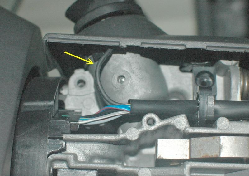

The particular wiring controlling that signal indeed runs through the column, its contact located inside the ignition cylinder key lock recess.
Here's a photo of the lower shroud removed, follow the arrow:

Thanks for the help guys! The old man decided to just pull the wire out and not worry about it anymore. He couldnt get it to sit in the right place. Moral of the story is, he's happy
