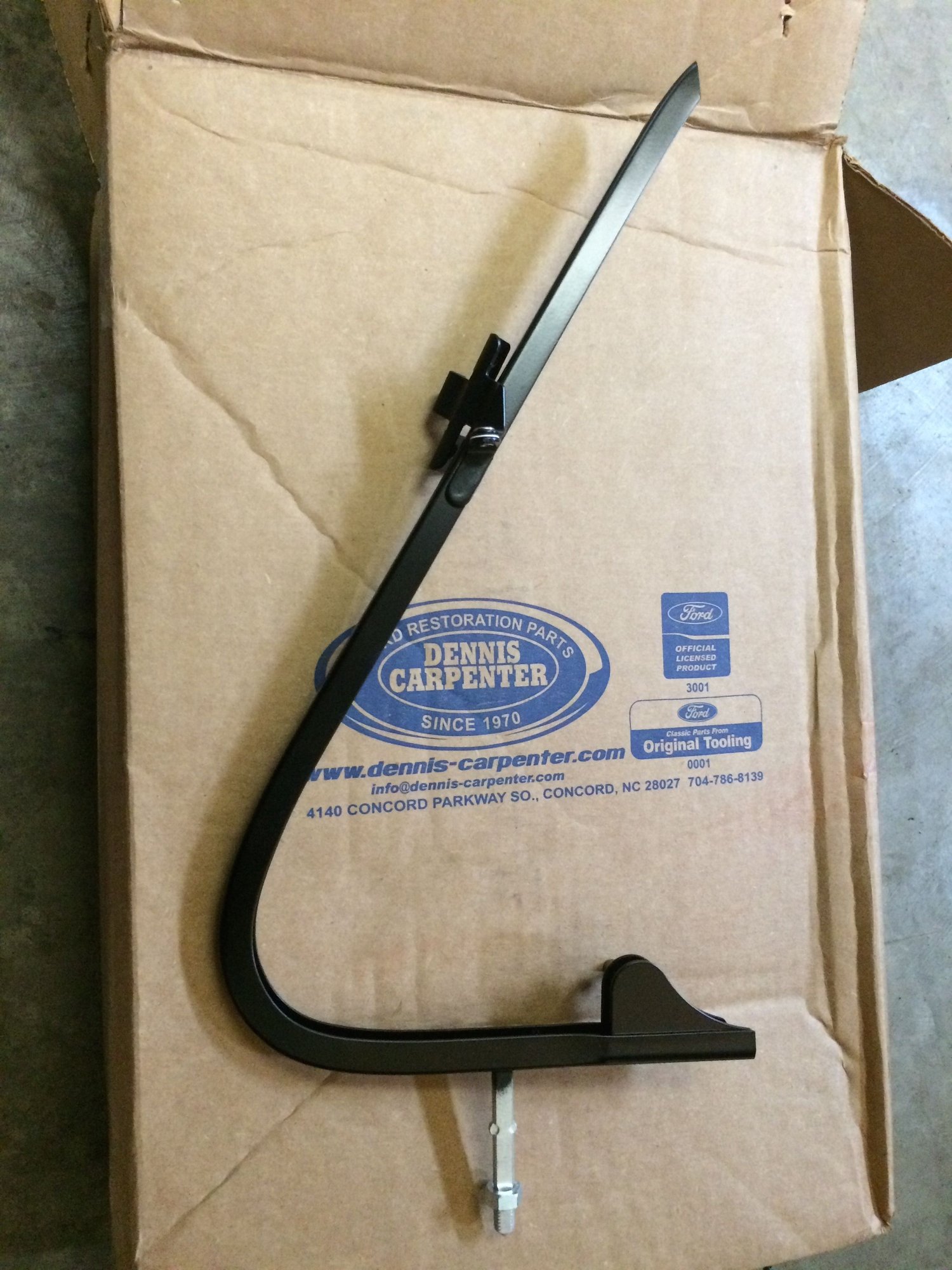

I purchased a new wing window frame and weather stripping from DC. Question is how do I remove the glass (Without breaking it) and what do I need to seal the glass in the new frame?
Pictures because everyone loves pictures, including me.

Oh boy are you in for a job...
I would get the frame and glass off the truck first and then carefully use a cut off wheel to cut the frame off the glass.
Cutting down the back side/middle of the frame to split it. I do not think you can just pull the frame off the glass.
Then get the wing frame installed and then hit up a glass shop for some of there super duper adhesive, and go from there.
You will need a very small pin punch to get the roll pin out, that holds the wing lock on.
I am going to go get you a complete pic of the wing bracket. BRB

Here is what you have to remove first, as an assembly, the wing frame and division bar.
Then there is a clip with one screw attaching the top part of the vent wing to the division bar and 4 rivets at the bottom.

I was afraid of that.... I knew I had to remove the glass from the door. So I just get the old angle grinder with a cutoff wheel and split the old frame right up the middle?
I may try to get a glass shop to do the installation of the frame if I go there anyway to get some of their magic glue.

1. Roll the window down, then be careful with the door panel removal (of course) to get to the one bolt at the bottom of the division bar.
2. Remove the one bolt at the bottom of the division bar.
3. Remove the one screw at the top front edge.
4. Remove the division bar push in gasket form the bar itself. With the bottom bolt out the glass will be loose in there and you should be able to get the whole seal out.
Of course masking off the inside and out side of the wing area door frame area to prevent scratches.
The frame will pull out and then tilt it either in or out and remove the whole assembly.
And yes I would use a thin cut off blade and split the frame.
