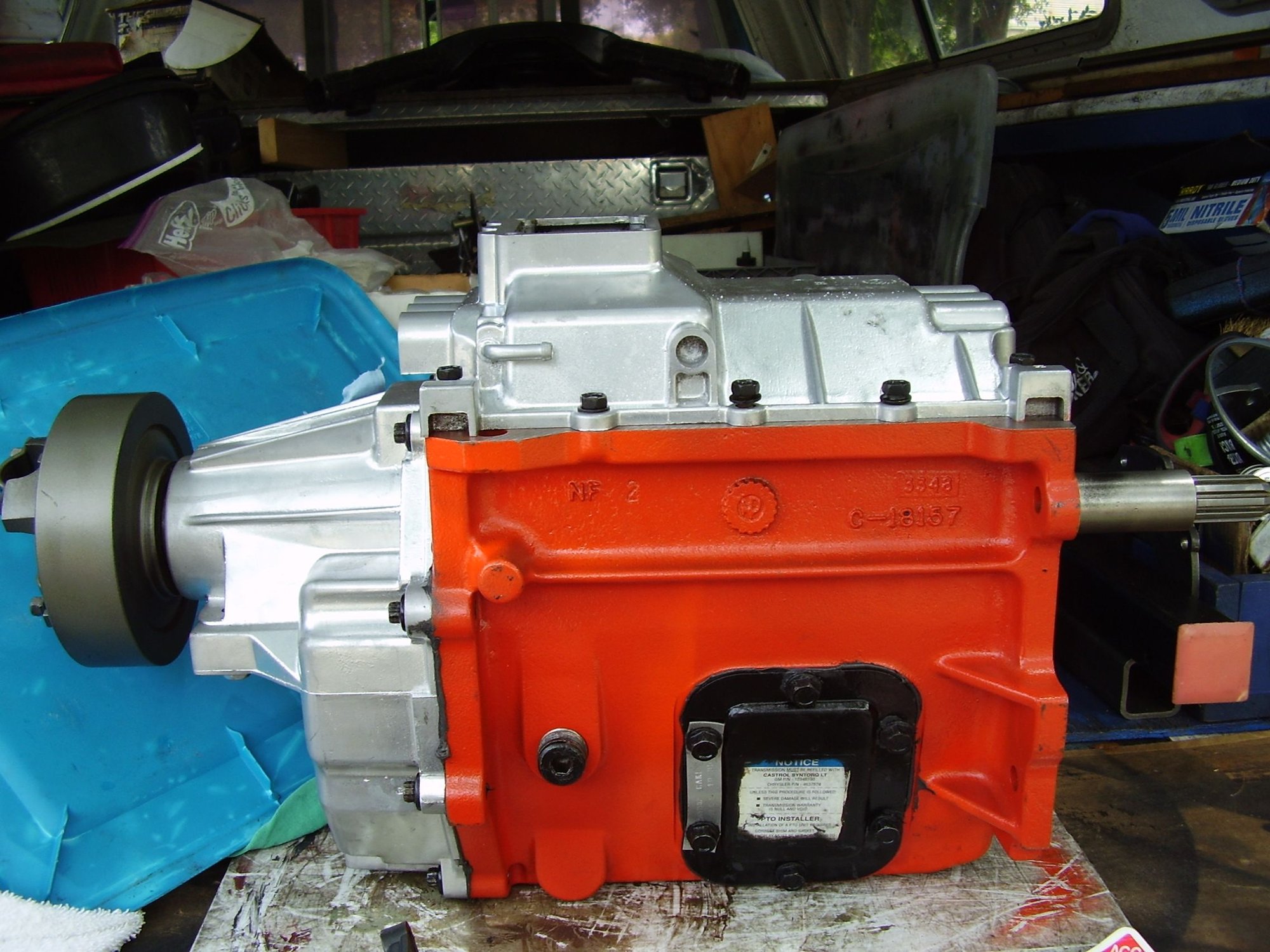

The nv4500 fits the Fe block pretty good and was a easy install for me.
Cost was about $1800+-some but, I install new flywheel & stage ll clutch setup but the oem setup can be used. Shorten driveline 6'' Moved the cross member back about 4" an used the chevy trans mount. Cut new holes for shifter sticks.

A Advance adapter was used to mate them.
Since my truck is a f250 4wd with the remote transfer case I had to change the tranny over to the chevy nv4500 rear tail shaft & housing as it makes it 6" shorter that is needed to keep drive line angle at 7* degrees.
As you can see the tail shaft.
The ford 2wd can use the regular dodge V8 gas eng. nv4500 tranny tho 6'' longer an less troubles.
As I did have to make a bracket for the 4wd shift lever to mount on the rear of the tranny.
This is the what the dodge long tail shaft looks like that can be used in the 2w fords
