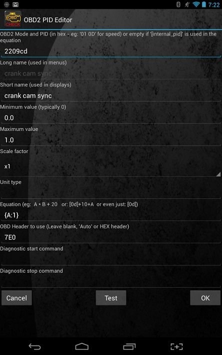

I'm using the torque app and I dont see a PID for CMP/CKP Sync. Anyone got any idea how to add it?

GenMan's Avatar
GenMan
Joined: Apr 2015
Posts: 113
From: Florida
click the little gear in the lower left corner.
click settings,
click manage extra pids / Sensors.
click the 3 dots on the top right,
select "Add custom PID"
enter the info below:
here's FICM Sync also,
