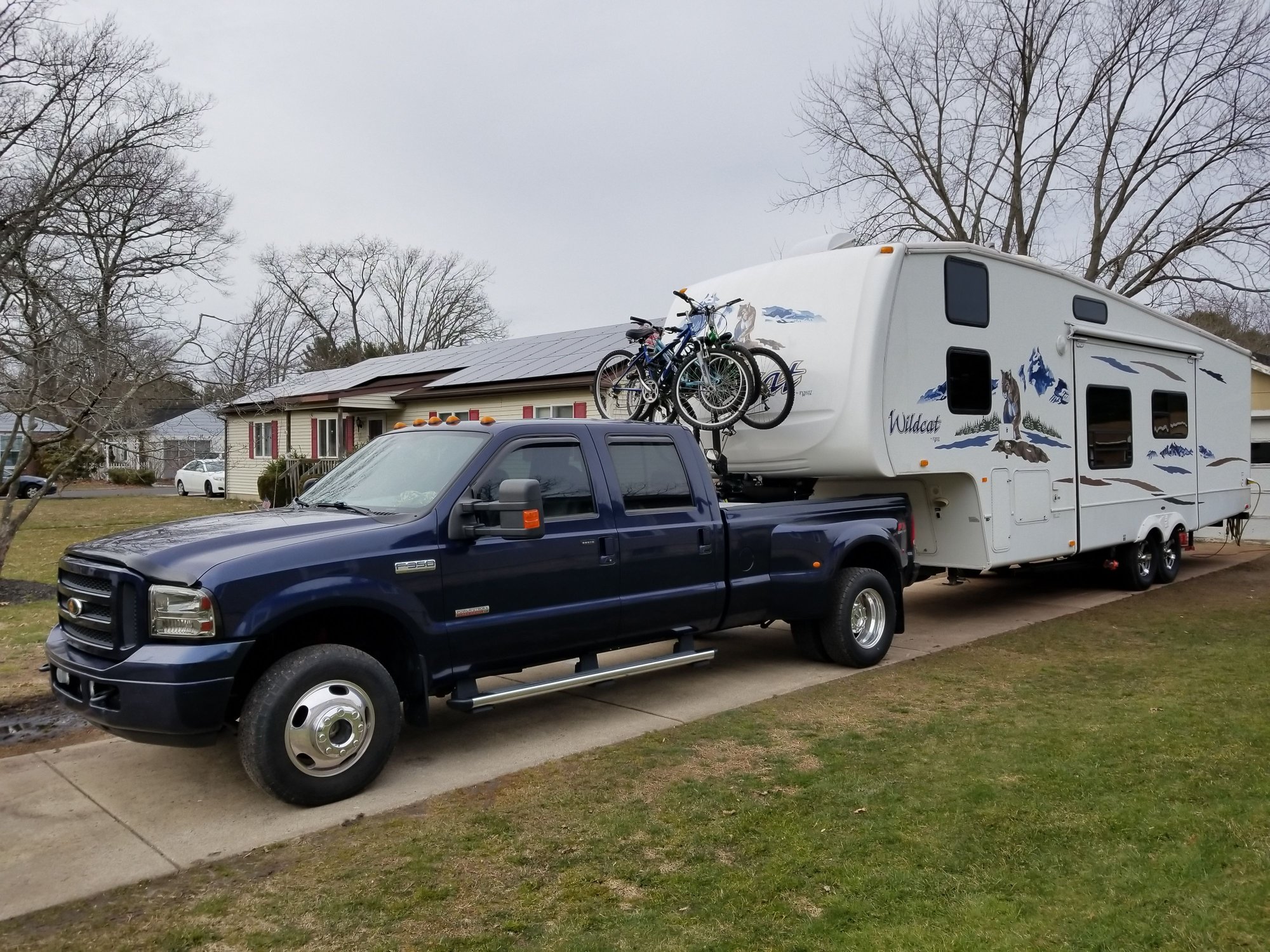

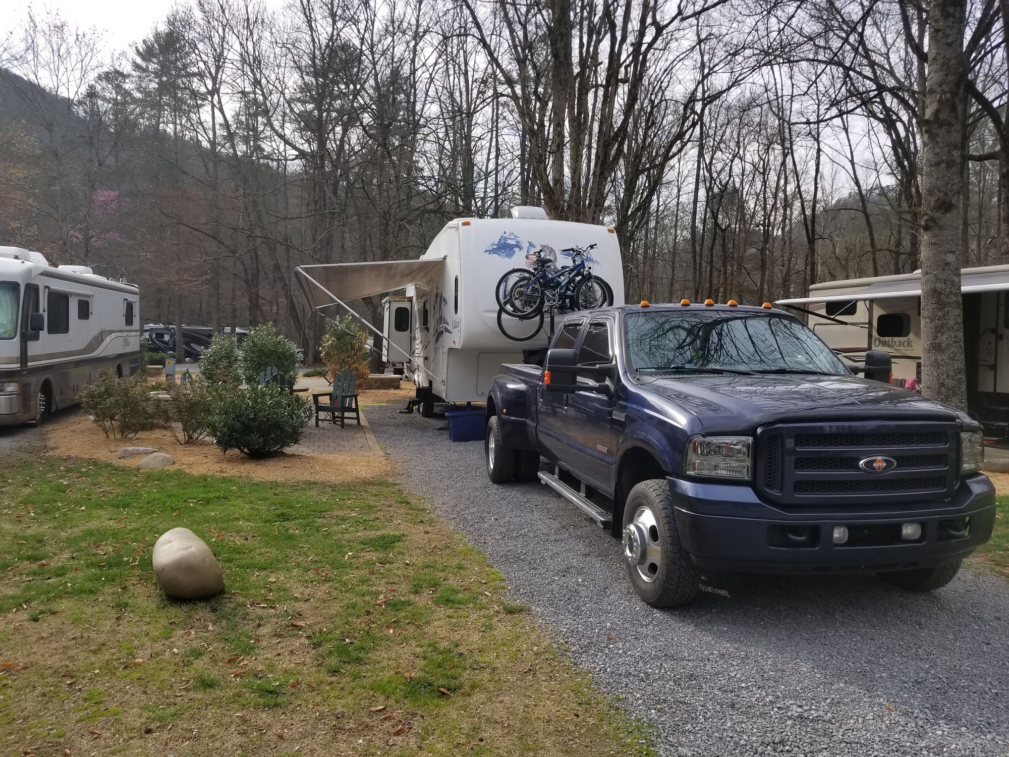

This was loaded up last week for our first trip of the season to Townsend, TN.
Small world... We were at the Townsend KOA at the same time. I saw you guys arrive and park. We were in your row. I noticed your bike rack.

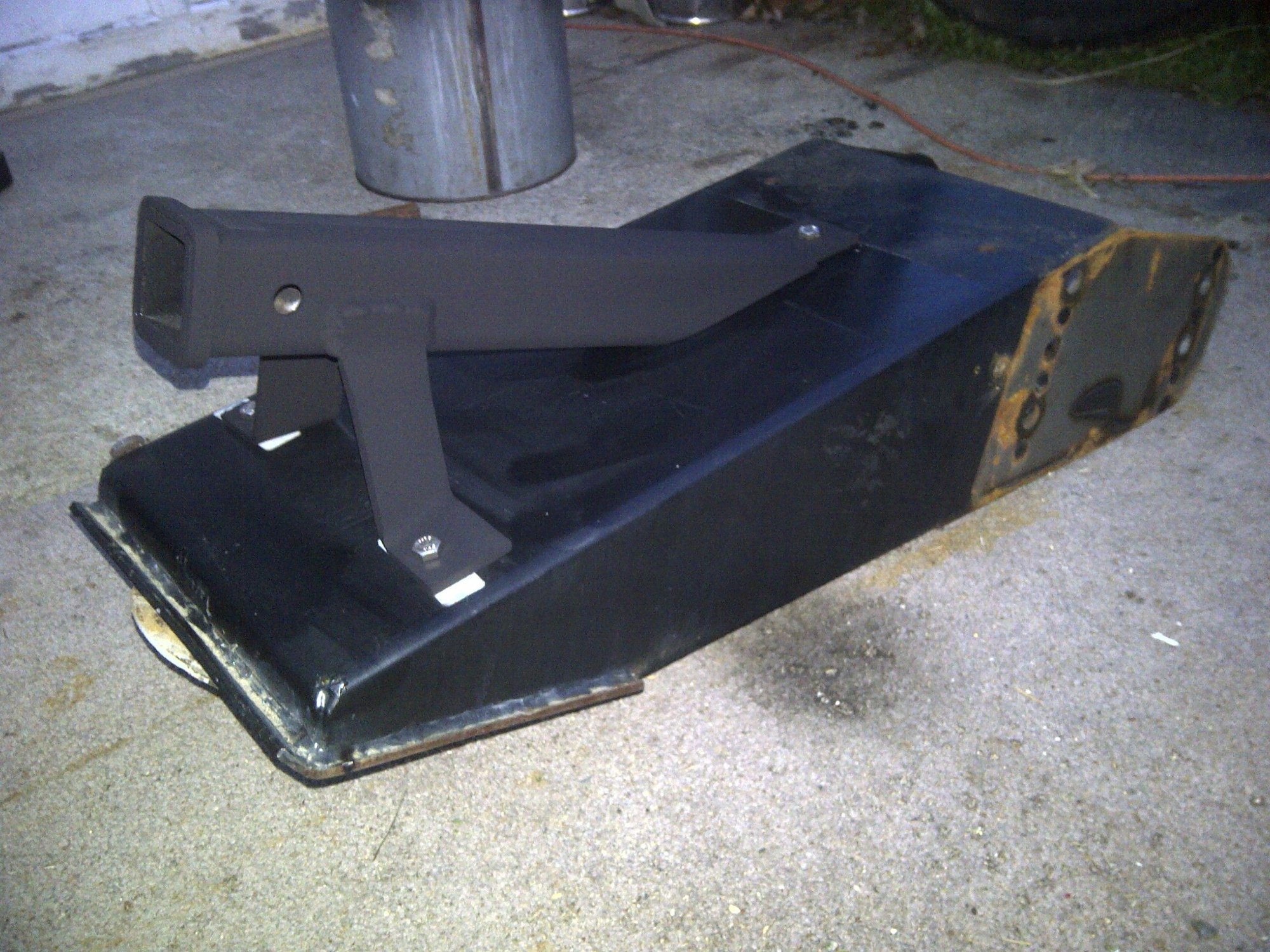

Good afternoon 87crewdually I just noticed that my standard pin box is sloped down do you happen to have any additional photo's of how you fabbed up the hitch for the standard pin boxes?

I cut the end of the tube to match the angle of the box. I then welded legs with tabs on outward angles on the front of the reciever down to the pinbox. In the end It has 3 points of attachment. If I remember correctly I used 3/8 bolts and .25 x 2 flat stock.

Perfect thanks! Looks like all I need to do is get the receiver this weekend and I can start putting this together and find somebody to weld it for me.

Shawn get your steel cut & fabbed then take it to any muffler shop & they'll weld it for you

That a good idea Gigger didn't even think of that. I had actually spoke with my maintenance department at work and asked them if they could do some welding for me.

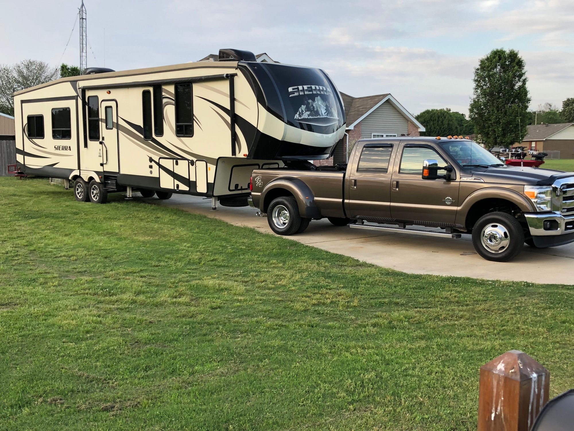

371 REMB Sierra hooked to my 2013 F-250
Updated Picture, ready to go tomorrow...

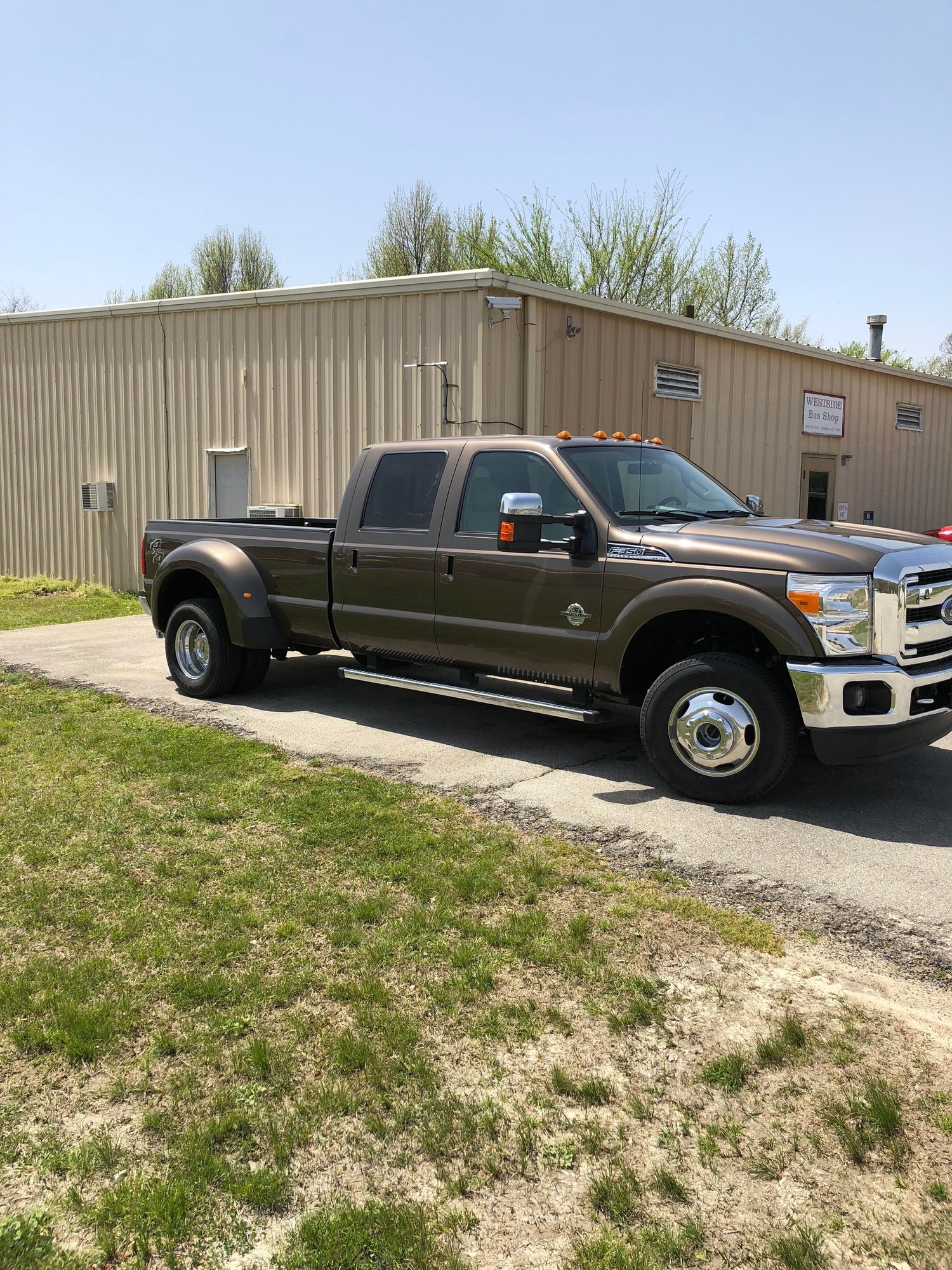

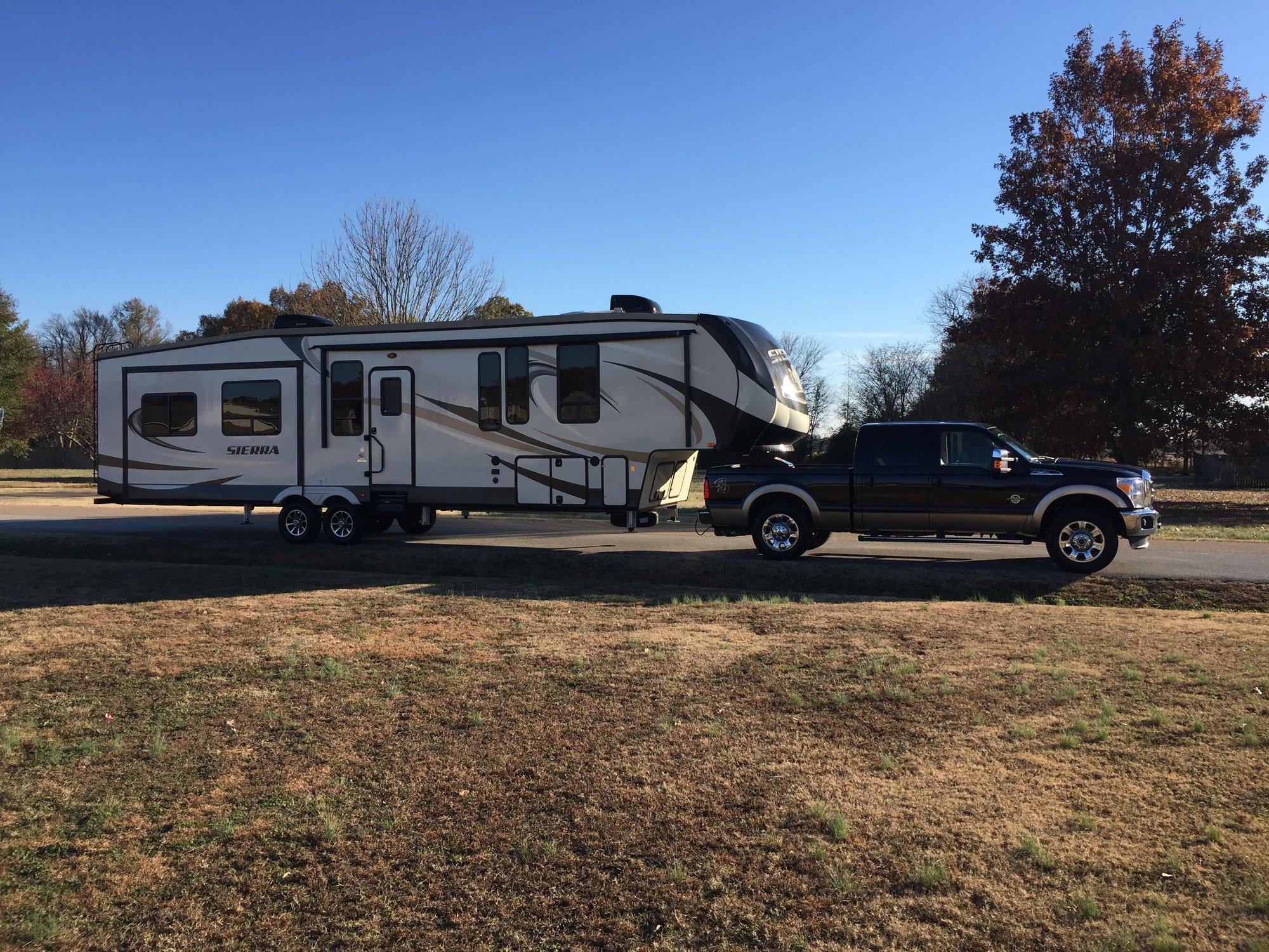

New to the Forum, here is a pic of my Sierra hooked to my F-250 with 50# pressure in the air bags, and a picture of the new tow vehicle a 2016 CCLB Dually Lariat with Ultimate package.
My 2013 F-250 hooked to my 44 Foot Sierra with 50# of air in the bags to level the ride some.
And my 2016 Dually that replaced the F-250, don't have a picture of it hooked up yet.
Looking forward to reading all the discussions and learning from such a large group of Ford Enthusiasts.

Great looking dually...ought to look great hooked up to the Sierra! Congrats..
