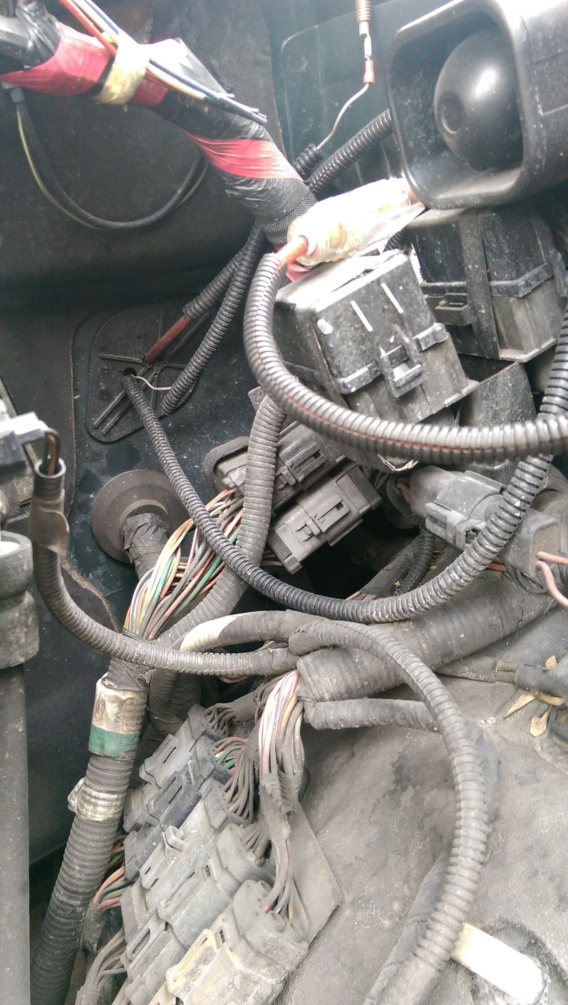

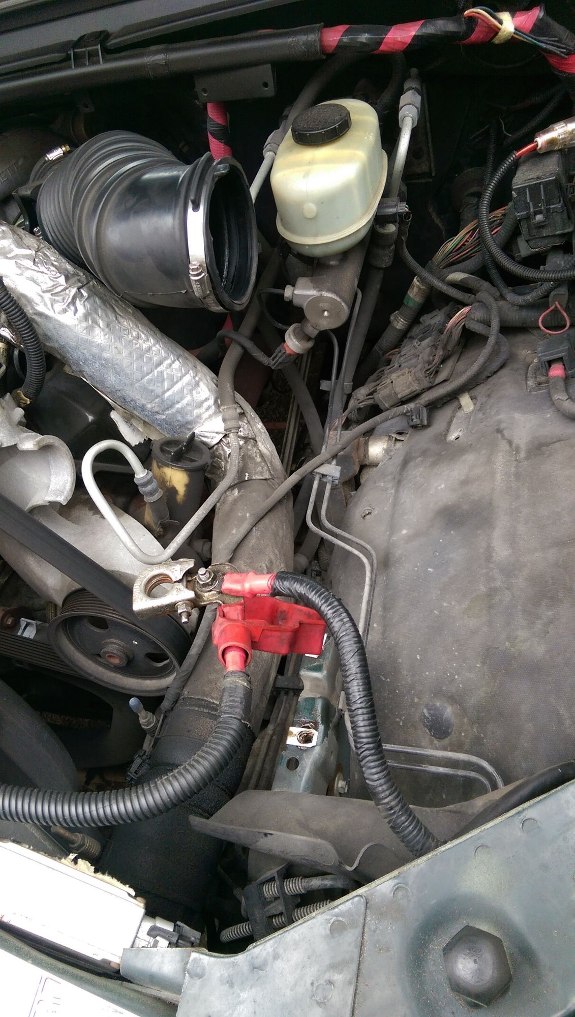

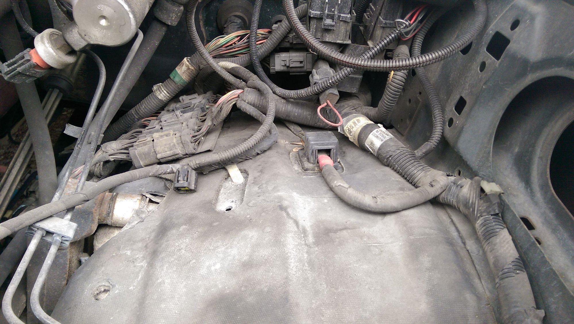

But then I look at the pics I took while changing the intake and it looks like my firewall is empty at that point?
Maybe somebody can spot it and help this thick-headed fella out

Should be this one. There will be a 10mm bolt in the middle of a rectangular plug.
Attachment 118521
After you loosen the bolt and pull the plug, the PCM is on the kick-panel near your parking brake.......in case you were looking for it outside

And the bolt stays in the plug. Once the bolt is loose and you remove the retaining bolts on the inside the PCM does not pull straight out...you have to move the end that is closest to you to the right toward the brake pedal and then pull.
