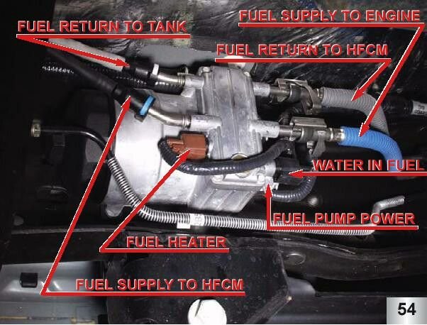

If you had a tank delaminate, you might want to take the lines loose at each end and blow them out. At least the fuel line to the HFCM from the tank. You can take the fuel supply to engine line loose at the HFCM and have someone cycle the key and see if any is getting through, and the pump is just too weak to lift it to the secondary filter.
Old Jun 17, 2015 | 09:21 PM
SuperVossen's Avatar
SuperVossen
Joined: Nov 2011
Posts: 122
Turns out there were two problems... first the fuel pump he got to replace the first was bad... and the water seperator portion of the hfcm was full of red dirt... go figure... and thanks for the advice if we hadn't figured it out we would definitely tried that.
