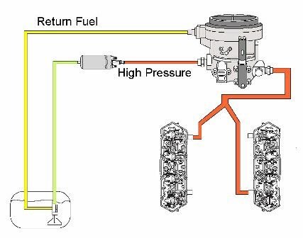

I don't think oil will make it to the fuel bowl on a sd since it's a dead head system
The sd system is different than the obs
Well, that is what I thought too until my fuel filter started turning black. When that happened I had already done the Hutch and Harpoon mod and had a pre-pump filter and a post pump/pre-fuel bowl filter. I did this in prep for a fuel bowl delete that I did not get around to doing for three months/15k miles.
When I changed my fuel filter 10k into that, it was black and I was wondering what the heck...then it was the same way and even worse 5k later when I actually did the fuel bowl delete.
The oil in the "dead head" system is pressurized to 2800-3200 psi and possibly even more with some tunes. The fuel is normally around 55-65 psi...one o-ring per injector separates all of that pressure. When one or more of them fail then the HPOP easily over powers the fuel pump. My truck also smoked worse during those last 15k and continued to get progressively worse. Oil consumption was also on the rise...1.5 qts per 1k at the end. Got on here and found that others had experienced the same thing. Replaced o-rings and that problem, huge amounts of smoke and oil consumption, was solved until I totally replaced the injectors. Oil consumption is now .5 qt per 5k using Rotella T6
